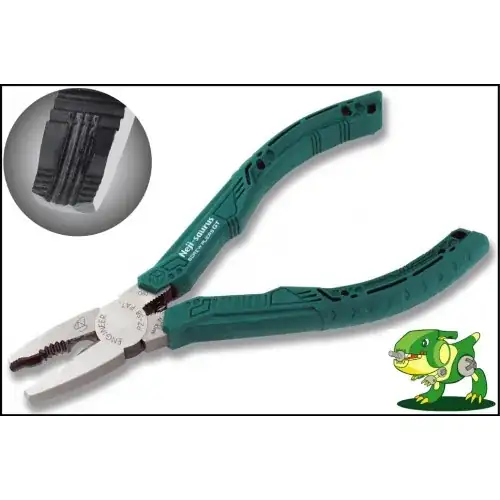

To remove a stripped/damaged screw easily, you can use a pair of specialized screw pliers. These have special jaws for gripping the outer perimeter of the screw head. Simply twist and remove.
Image from this link: http://www.precisionhandtools.co.uk/screw-pliers/engineer-pz-58-neji-saurus-gt-multi-purpose-pliers-with-screw-extractor-jaws
