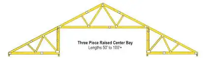

It is possible to create both the space needed to elevate the car, and have a structurally sound garage given the picture. For instance, additional chords can be installed low enough to recreate trusses, but high enough to accommodate a raised vehicle. There are a number of truss styles that do not use a horizontal bottom chord, the scissor truss for instance. And using steel as a construction material can help to redirect the tensions through materials more capable of absorbing the load. Lastly, the walls themselves can be modified. It was typical of cathedrals to buttress on the exterior, the wall to handle high-arching ceilings, for instance.

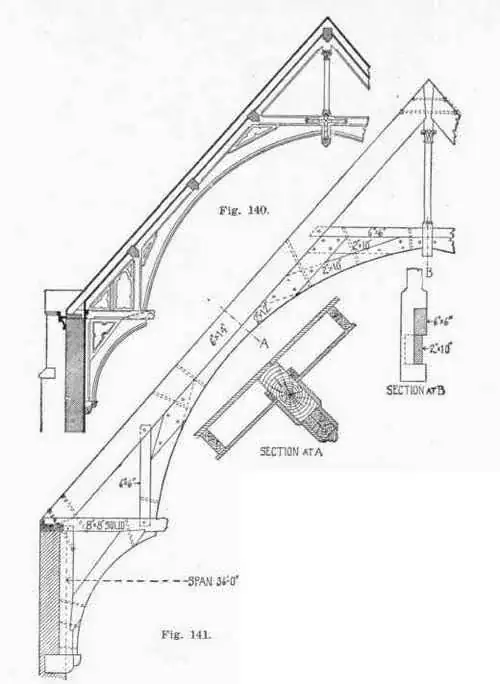

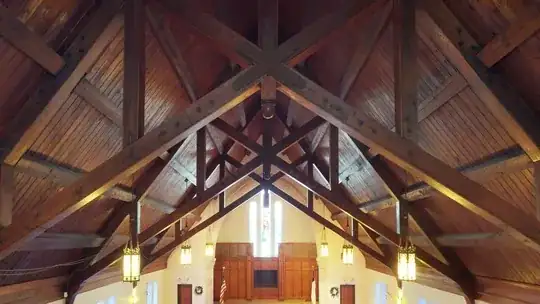

From https://www.truss.co/blog/when-a-church-redevelops-into-retail-property This one is a Scissor Truss, and also wears the more general name "church truss" or "nave truss" Note some of these have thinner tie rods across the middle exactly where the bottom chord would be - those aren't suitable.
A little ornate for a workshop, but you can see how the load is being brought down to the walls with inner buttressing.

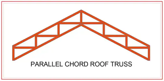

https://www.alphasteel.ph/wp-content/uploads/2018/08/parallel-chord-roof-truss.jpg This would work too - depending on how much height there is at the top of the wall.

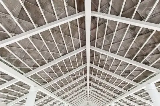

Now that everyone has upvoted this as unsafe, I’ve got to take the other side of the argument for several reasons: 1) it’s not a truss, 2) it’s “stick-built”, 3) either side could be removed and the remainder would be stable, 4) horizontal structural support is elsewhere other than in the center horizontal span,
1) Look close and you’ll see that it’s not a truss. The structure does not create a truss spanning the room...or it would have collapsed immediately...especially with that much removed.
2) The members are stick built. The roof member spans from ridge to next support...diagonal brace. The roof member is in both tension and compression. A truss member is in EITHER tension or compression. (That’s why “double bending” in truss design is so dangerous.) The loads are transferred down the diagonal members to the walls or cantilevered beams over walls. In truss construction, loads are transferred to the END of the truss.
3) If you look at the right side you’ll see that it could be removed and the left side would remain structurally sound. That’s an indication that it’s not a truss structure , but a stick built structure. (One half of the roof structure looks like a picnic shelter.)
4) The horizontal stability is in the end walls, NOT the center ceiling support. That’s why you don’t see large cracks in the ceiling gypsum board.
Now, I said “if” at the beginning. The “if” is in reference to the need that each side must be horizontally stable and has at least 2 bearing points on each side of the opening.....and obviously it is so far.
