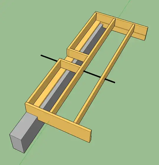

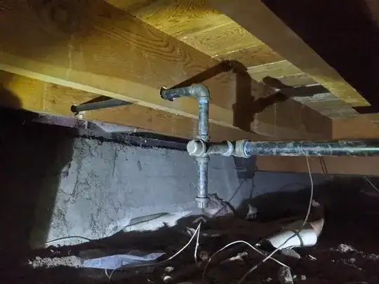

I was running some new gas pipe and I notched one floor joist and drilled a hole in another. I have now learned that this is not appropriate. This was in the forbidden zone of the middle 1/3rd of the joist.
The joist is 7 inches tall and the notch is 1.5 inches tall. I think the wood is redwood. The span is roughly 100 inches. This is an old house, built in the '40s.
  • Here's a photo from the day I made the notch: drilled joist
  • Here's a quick sketch of the situation: sketchup diagram

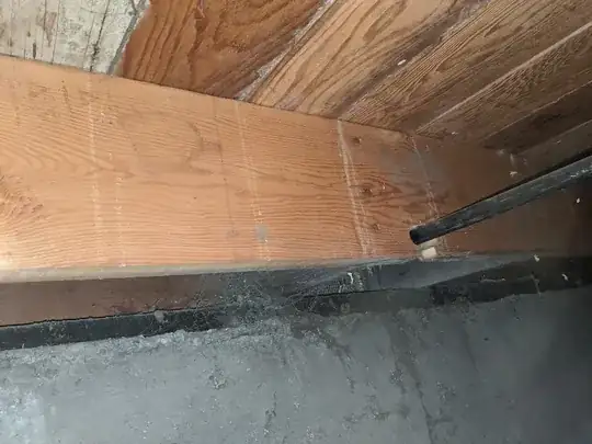

I went back a few days later and took a close-up picture. There are some horizontal cracks. If you look very closely in the original photo, these cracks were pre-existing to some degree.
  • Here's a close-up of the cracks enter image description here
This joist is close to the foundation (as you can see), and the notch is under a bedroom closet. I'm not sure if the closet wall is load-bearing.

  • The cracks are normal. No big deal. Search on "Checks and Splits in Lumber" for details.

These are larger than 2x6 joists. That plays in your favor. A notch in a 2x6 is disastrous. The beams look OK for now. The cracks are horizontal so they're not concerning. Those can be caused by the drying of the boards or settling, and they could predate the notches.

Fourth, those hairline horizontal lines are from the wood drying out and are located in the “neutral axis”. The neutral axis is that portion of the joists that has neither tension nor compression (prior to you drilling the holes).
