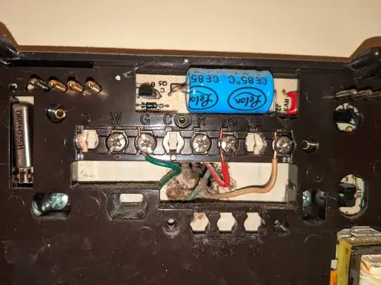

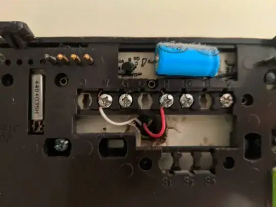

Below is the wiring to one of our thermostats (Set for heating): Heating thermostat
Below is the wiring to the other thermostat (Set for cooling): Cooling thermostat

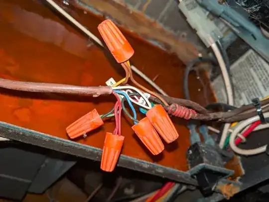

Below is where the cabling from each thermostat, and to each of the gas furnace and unit outside for electric cooling, cables converge: (The cable with the red wire wrapped around it goes to the outside box with a fan in it; the condenser? The other cables go up through inaccessible wall cavities to each thermostat, but without a continuity tester that can be used to test one wire going to different locations, assume that the cable with the blue and green wire wrapped around it at the back of this bundle is the one that goes to the heating thermostat, with the other to the cooling thermostat). Junction point for cabling to heating, and cooling systems, and thermostats

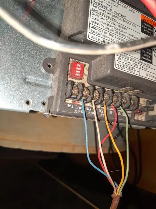

Below is the wiring block for the furnace: Wiring for furnace

Your system only has 1 transformer, at the furnace
Given what we know (that the cable with the red wire back-wrapped at the junction point goes off to the outdoor unit), we can tell that the orange wire from that cable is tied into the Y connection (orange wire) from the cooling thermostat and the Y connection (yellow wire) to the furnace as well.
This means that the other (black?) wire from the cable to the outdoor unit must be connected to C for this to work in a one-transformer configuration, and indeed, it connects to the blue C wire going off to the furnace. Furthermore, the red R wire from the furnace goes out to the red wires in both thermostat cables, which is also a sign you have a one-transformer system.
