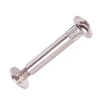

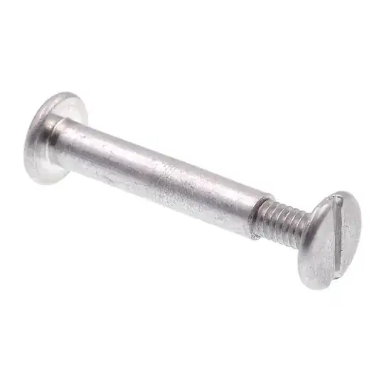

I've had good luck with so-called "connecting screws". They are a two-part design, with both sides having a head. One end is like a machine screw with a pan head, the other part has a pan head, but the shaft is hollow and threaded for the opposing end to screw into. They are designed specifically for this purpose. You can get them in various lengths and colors. Colored ones tend to be plastic, while you can buy all metal ones as well.

Screws are a bad idea. A #8 IMHO isn't thick enough. And 2" long is about 5/8" too long if you are using the standard 3/4" melamine coated chip board. I think you need to distribute the load over more surface, or use a lot of fasteners.
Remember Murphy. If you have a wall that is half an inch out of flat, you are going to try to uses these screws to bend the cabinet. This won't happen, but it will try. I have a house where the center of the kitchen, and the wall separating it from the dining room settled 2 inches over 20 years. And another wall that has a 1 inch bow in it over 12 feet.
The head distributes the load over more cabinet. I don't like the particular style with the slot connectors.

M6 connecting screws mate perfectly with 5mm shelf pin holes in EuroStyle cabinets. Using these screws, I typically join cabinets together thru the shelf pin holes. It makes for perfect alignment every time in comparable cabinets. Hafele, among others, has these screws in their catalog.
