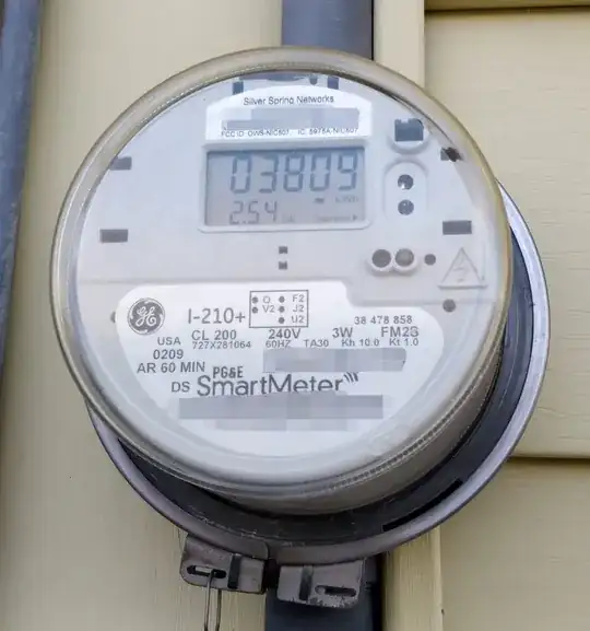

House Covered area: 1460 sq feet Meter photo: enter image description here

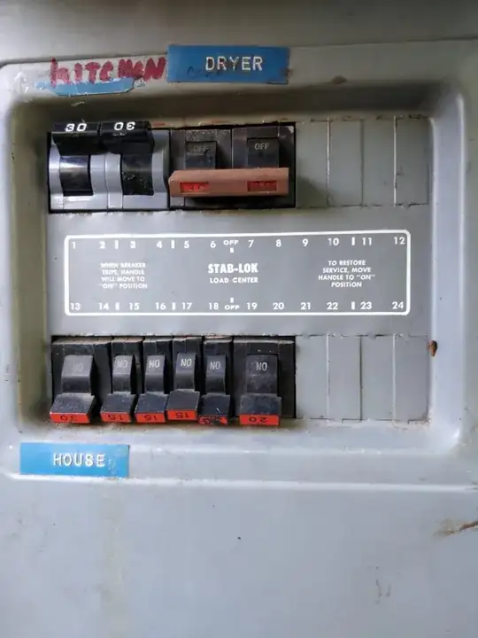

Main panel: The marking in Red deciphered as 'Kitchen' enter image description here

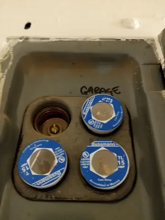

Subpanel1: (in the hallway, this is the one which is very high as mentioned in the notes) enter image description here

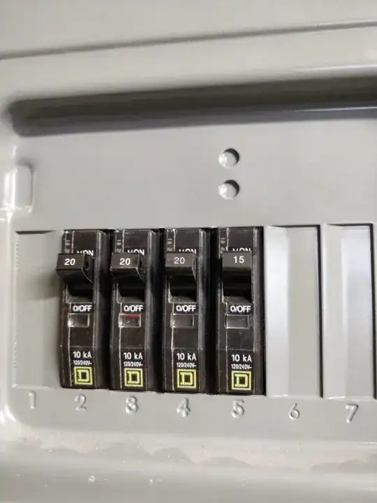

Subpanel2: (This is physically located in the garage, ironically the other subpanel has a marking "Garage") enter image description here

Subpanel 1 is old fuses. Small, but nothing inherently wrong with it (at least not without more details/examination).
Subpanel 2 is Square D - Good stuff.
Main panel is a Federal Pacific Stab-Lok firestarter
I am not a professional electrician (barely an amateur) but I have seen enough here on DIY and on other sites to know that is a BIG problem. See, for example:
Should all Federal Pacific panels be replaced?
In addition, even not being a professional, those breakers look nasty.
Replace as soon as you can afford to do so.

You may also want to replace the small fuse subpanel for similar reasons (GFCI, AFCI, add more circuits, etc.) but that is NOT a known danger like the Stab-Lok panel.
