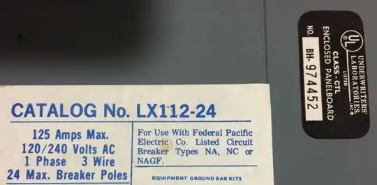

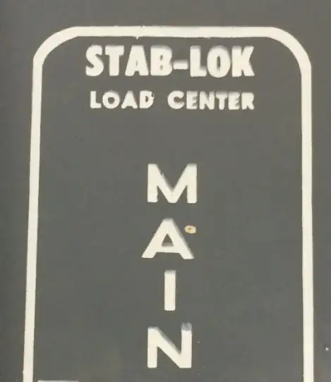

Yes, I'm making a second answer. Why? Because today I needed to shut off a circuit in an old stab-lok control center. I flipped the breaker and fortunately I checked. It did not actually turn off.
I fiddled a bit, it disconnected, I bumped the wire with my screwdriver, it came back on. I sort of shook the breaker into submission and it finally seemed to stay off for long enough to do the repair.
Very very very dangerous.
Keep your Knob and Tube, ditch the Stab-Lock
Stab-Lok Load Center UL Listing Federal Pacific Panel - Dangerous
Update: same circuit is still there, carpenter working attic, electrical short. Huge pile of sparks. Carbonized a nail. Did the breaker shut off? Yeah, eventually.
Total fail.
These breakers are garbage.
