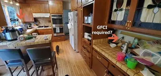

According to this answer, all receptacles in a kitchen that serve a countertop surface must be GFCI protected.
Which Kitchen outlets do NOT need GFCI?
I already replaced the outlets next to the sink with gfci and will now replace an outlet located on the opposite side of the kitchen sink, so my understanding is that I must replace with a gfci (and tamper resistant too?). I have no problems following code, but I'd rather understand the reasoning behind code. Why does this receptacle need to be gfci protected if it is far away from the sink?

(Is that outlet in the kitchen, or is it in the dining area? If it's in the dining area, it might not need GFCI.)
The reasoning I'd give is that kitchen outlets are much more likely to be dealing with water than other outlets, even if they're nowhere near the sink. You could have a coffeemaker, or slow cooker, or microwave, or bread maker plugged in there, all of which can have both water and electricity in the same appliance, which increases the possibility of electric shock.
