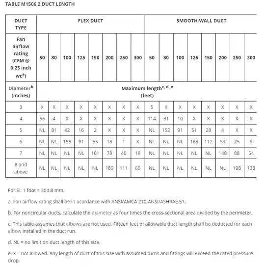

But searching the web also lead me to IRC table M1506.2 Duct Length, which I understand to say that a higher CFM also needs a larger duct.
So I think I'd need to use 6" duct, rather the then 4".
IRC table M1506.2
Am I missing something? Confused as to why the answer above seems to penalize 6" (flex) duct when the IRC seems to indicate 6" is a requirement.
