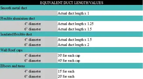

Calculate Equivalent Duct Length (EDL)
The next step is to measure the length of the duct run, and then apply some additional factors to determine the equivalent duct length of the run. For example, if we had this situation.
  • Duct type = Insulated Flex.
  • Duct length = 15'.
  • Duct diameter = 4".
  • Number of elbows = 2.
  • Number of wall caps = 1.
We'll use these numbers, and the chart below to determine the EDL.
EDL Values
So the example above would look like this.
15' of 4" insulated flex duct x 1.5 = 22.5'
4" elbow adds 15' x 2 = 52.5'
1 4" roof cap adds 30' = 82.5'
Which means in our example, the EDL is 82.5'.

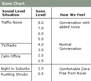

Everybody Wants It Quiet
In my opinion, getting the hot moist air out of the building is the highest concern. Though it would seem, some tend to like it quiet while the air is cleared.
You'll find that exhaust fan loudness is measured in Sone, where the lower the value the quieter the fan. If quiet is important to you, you'll want a fan at or below 1-2 sone. Here is a chart from Panasonic, that might help put sones into perspective.
Sone Chart
