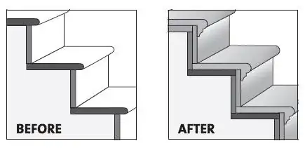

I'm looking to install false stair treads and risers on my basement stairs. Generally, we're talking about a kit like this:
Which is installed with adhesive and finishing nails like this:
The project itself looks fairly straightforward, but I have an issue with product choice.

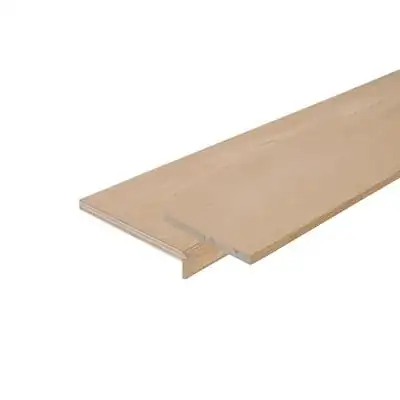

One product is MDF (IKEA Board) with 3/16 oak laminate on the tread surface, and the usual paper thin layer on the risers.
The other is plywood, with a similar laminate layer.
The price difference is pretty much a wash, so there's no clear advantage either way on that front.
Is there any reason I should choose the MDF over plywood or vice versa?

If it is MDF or HDF (as opposed to particleboard) then I would choose the fiberboard over ply.
Any surface wear will impact the finish laminate, regardless of the underlying material. By contrast, MDF/HDF should be more impact resistance, water/mold resistant and uniform in density and composition.
MDF versus Particle
MDF above: more uniform and dense. Particle below, less uniform and dense.
Matthew
  • 10,823
  • 64
  • 109
I would select the product based on the appearance and durability of the finish laminate alone, with little concern for the substrate material, assuming the substrate is some viable material and not pressed paper pulp or something else obviously inferior.
For identical finish laminates, MDF would be preferable to plywood as it is denser and more dimensionally stable.
bcworkz
  • 11,578
Personally, I am not a fan of MDF for any use--but especially in a high-use area such as stairs. My oak plywood stairs have held up great for 30 years in a house with 4 kids, multiple dogs, and grandkids. I think this should speak for itself.
