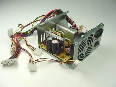

So instead of buying several small 12V adapters I go to the next best thing. A computer power supply!

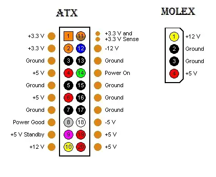

You can get really cheap ones like 450Watt and they can power up tens of strips with clean 12volt power, with short circuit protection and overload protection. This is a DIY Q&A so there needs to be DIY involved! Using a Computer PSU you are only interested in the yellow and black wires. The rest you can cut away/discard.
Here is a diagram showing the pinout computer PSU connectors.

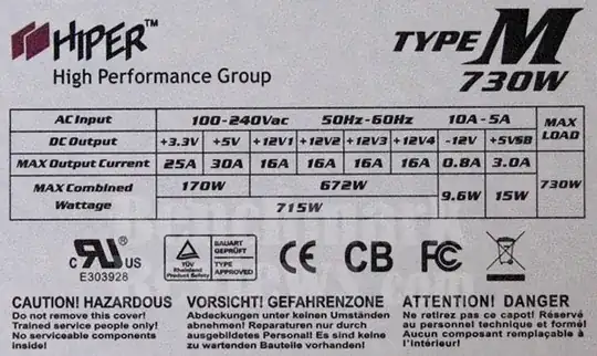

You need to realize you cannot just join all the yellows and use it as one. Each yellow wire is a PHASE and each phase has a maximum amperage rating. All the phases give the power supply its maximum peak rating.
As long as the combined amperage/wattage does not exceed that written on the label of the PSU you will be OK to combine many LED strips to a single phase. But each 5 Meter LED strip will need to be powered individually to be safe. So you need to pull wire alongside all your led strips if you're going to go more than 10M :(

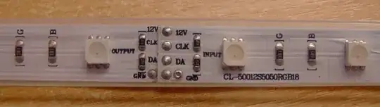

Joining LED strips
Picture worth a 1000 words
Just match up the pads, join them like that or use some cable. Does not matter.
