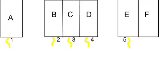

I want to install hardwired, under-cabinet lighting, but I need some guidance on what kind of devices (transformers/drivers/adapters) I need to complete the project. I know very little about electricity and even reading some of the electrical answers on this site (like this one) have my head spinning so I'm hoping somebody can just tell me what I need. Here is my situation:
The rectangles (A-F) are my wall kitchen cabinets. The yellow wires (1-5) are the wires already setup (connected to a wall switch), on a single circuit, carrying 120VAC. 1 connects to 2, which is connected to 3 and so on.

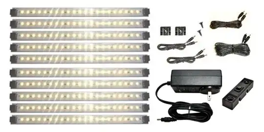

I want to use something like this. LED Lights
However, my difficulty is most of these LED under cabinet light solutions on Amazon seem to be assuming that you have one set of cabinets, where you can link all of your lights in a perfect row, and one plug that you will then plug everything into. I don't have that. I have 5 120VAC lines, and one of those lines (#5) needs to have 2 lights interconnected (for cabinets E and F) on that one line (why it was setup like this is another story).
So if I were to buy the light kit above (or something similar), please tell me what [else] I need such that;
  1. I can plug a single LED strip (or puck) into the 120VAC lines on cabinets A, B, C and D
  2. I can plug two LED strips (or pucks) into the 120VAC line on cabinet E
In case it matters, the scenario illustrated here is slightly more simplified then my actual setup. In my actual setup, there are two more cabinets. One touching cabinet 'F' (call it cabinet 'G'), and another cabinet which is stand-alone just like cabinet A (call it cabinet 'H'). So there are really 8 cabinets, and 6 lines coming out of the wall, but I didn't include them in the picture to try to simplify the scenario. I add them here incase it matters (for voltage/wattage/amperage/gigawatt consideration).

I just installed these under some cabinets, and they work great.
Most LED under cabinet lights are similar so... Each "strip" is made to chain to the previous strip. In my installation, the first strip is plugged into an outlet with the large transformer you have pictured, and then a 12v jumper goes from the first to the second, second to the third, etc. I have 6 lights in a chain.
You installed 5x 120v drops... You could have a transformer at location #1, #2, and #5, and chain #2>#3>#4 and #5>#6. For each separate 120v connection you will need a duplex outlet and a 12v transformer. For the lights that I linked, the barrel connector on the transformer needs an adapter to fit the smaller barrel of the lights, so pay attention to that as well.
Amazon sells the transformers and jumper wires separately, so you can buy them as needed.
