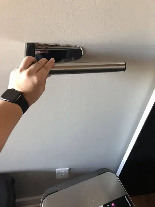

I'm probably overthinking it, but I'm trying to mount the SimpleHuman horizontal paper towel holder. It turns out that the best place for it is in the middle of the inner wall (5.1 inch wide) but above a socket which is located on the bottom of the wall. The three screws are about 1.1 inch each. I'm not drilling a hole, just using a normal mechanical screwdriver. Is this a concern at all?enter image description here

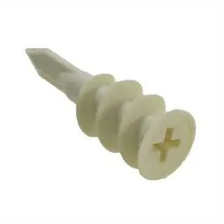

Grab yourself some drywall (plasterboard) anchors or spring toggle devices to get a better hold on the wall. The former looks like a big plastic screw, with room for another screw in the middle, and a flat tip. This is is shown in the first picture below. These bite in to the drywall (plasterboard) and get a firm grip, providing you with a rigid hole to screw in to.

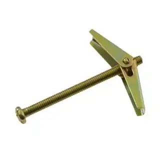

The latter (spring toggle, second picture) consists of a screw with spring loaded wings that spring apart after you push them through a wall. Naming may be different in the US, but I would expect they would still be readily available. The objective here is to distribute the load of the holder (and anybody pulling on it) over a greater area to avoid ruining your wall.

I wouldn't worry too much. Modern electrical standards have wire stapled an inch and a bit back from the interior of the drywall. If your screws are less than 1.5" long, you shouldn't hit anything. If you are pre-drilling for drywall plugs, only go 5/8" in.
It's ideal (and still safe) if you get one screw into a stud. There should be one either on the left or the right side of that outlet.

As pointed out by another poster, generally, but not all the time, there is a stud on the right or left of an outlet. Usually studs are on 16" centers, but in smaller rooms like bathrooms they may not be. A hot wire detector is a good tool to identify where wires may be, but a stud finder is a good way of detecting where the studs are. So using a stuf finder (or your knuckles rapping on the wall, and detecting sound changes), I would identify where the stud is. Then I would try to get one of your mounting screws into a stud.
For the other screw, I would consider a plastic insert that goes into the drywall, and using a screw that only protrudes 1/2 to 5/8" past your holder into the wall. That will reduce the possibility of hitting a wire.
