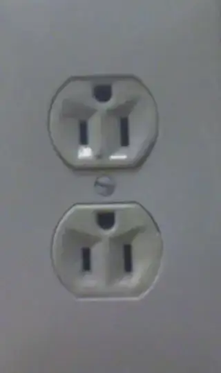

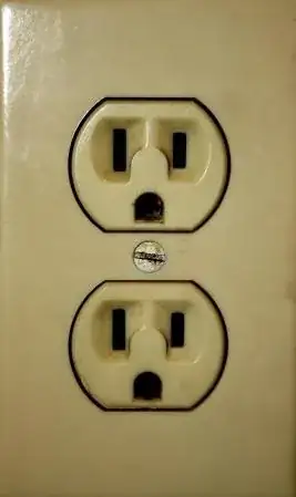

My house has electric outlets in both orientations. Which one is correct? Should the ground hole be at the bottom or the top?
common electrical outlet (NEMA 5-15R duplex), ground hole on bottom
OR
common electrical outlet (NEMA 5-15R duplex), ground hole on top

The ground pin is usually facing down, and, if I recall correctly, when I installed some tamper-proof receptacles recently, the printing on them was right-side-up with the ground pin down. I believe it's also a requirement in some localities.
On the other hand, people supposedly install the ground pin facing up as a safety precaution: if you're falling or dropping something onto a plug that's not securely plugged in, you'll hit the ground pin first so there's no risk of a shock. If you've got both orientations within any one room, it's possible the installer didn't know what he was doing.
If your locality doesn't have a requirement for them to be facing down, I would just pick the orientation that you prefer and re-install the ones that are in the other orientation to match.
