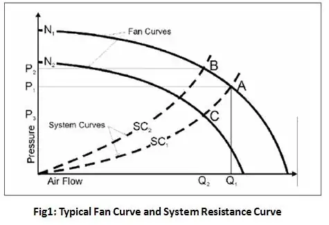

Your Installation's Resistance Curve
Each installation of a range hood will have its own resistance to the flow of air. This will depend on the restriction of the entire air flow circuit. The most common sources of restriction in that circuit are the following:
  • the make-up air path into the suite
  • the grill or screen in the air path above your stove
  • the fan assembly itself
  • the ductwork between the hood and the outdoors
  • the grill and backflow preventer where the duct exhausts outdoors
  • wind that opposes or aids the flow of air from the make-up air to the exhaust locations on the outside of the house (this often happens when the two are on opposite sides of a house's exterior)
Resistance curves plot the air pressure the fan will encounter versus the air flow that the fan is pushing. A characteristic resistance curve follows an affinity law and is therefore parabolic in shape.
SC1 and SC2 in Fig1 are examples of resistance curves. The two different curves emerge when something about the resistance of your installation to air flow changes. For example, SC1 might be the resistance curve with a kitchen window open (less pressure required for the same amount of flow) and SC2 might occur with all windows close (it would take more pressure to achieve the same amount of flow).
Fan Curves
For a given RPM, each fan has its own relationship between the flow it produces and the pressure that has to overcome. These are shown in Fig1 as curves N1 and N2. The RPM of N1 is higher than N2 and, accordingly, it produces more flow for the same amount of pressure.
Determining the Flow Rate
The actual flow rate achieved is found at the intersection of your installation's resistance curve and your fan's curve. So, in our example, with the windows closed and the fan at the higher RPM, this is the intersection of N1 and SC2 indicated on the plot as "B". In HVAC engineering terminology, this intersection is called the "operating point".
How Air Flow is Specified for Range Hoods
Air flow of range hoods is specified at zero static pressure. In Fig1, this corresponds to the flow rate where N1 and N2 cross the x-axis. The specification provided by the manufacturer is not the air flow you will achieve once the fan is installed because there is no real-world situation where the static pressure encountered by the fan is zero.
The Type of Fan Substantially Affects the Fan Curve and Real-World Flow
You are unlikely to be able to obtain either a fan curve for a given range hood nor a resistance curve for your installation. This is not a practical problem in selecting a fan. That is because range hood fans are one of two general fan types each with a dramatically different capability.
Centrifugal Fans
Curves N1 and N2 are typical of a centrifugal fan in that they are able to create meaningful airflow despite static pressure encountered in the installation.
Axial Fans

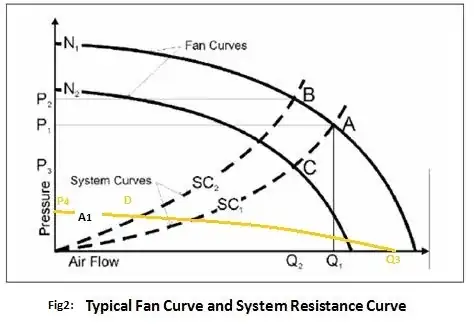

Fig2 shows a third fan curve A1 which is typical of an axial fan in that it stops producing any meaningful flow at very low static pressures.
Qualitative Comparison
Note that if you were to look at the manufacturer's specifications for the centrifugal fan that has curves N1 and N2 it would be in the same ballpark as the axial fan with curve A1.
But look what happens when these two fan types encounter the resistance of your system with the windows closed (SC1). The operating point of the centrifugal fan at the high RPM is shown at "B" while the operating point of the axial fan is shown at "D".
Note that the air flow of the axial fan when installed is only about 1/3 of the centrifugal fan despite the manufacturer's specifications for airflow being comparable.1
Note also that the airflow at the operating point is only about 1/4 of the manufacturer's specification for the axial fan, while it is more the 3/4 for the centrifugal fan.1
