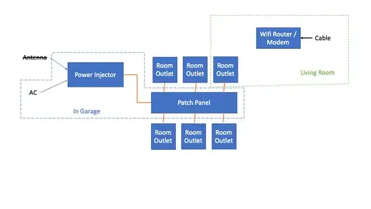

A diagram of what I think is my wiring setup is provided below. There used to be an antenna mounted on my roof with a wire that enters my garage and connects to a "Power Injector" before joining a patch panel. All the rooms in the house have an ethernet outlet that I assume lead to the other wires in the patch panel.
Wiring diagram

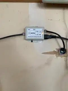

Here is a picture of the power injector.
Power Injector

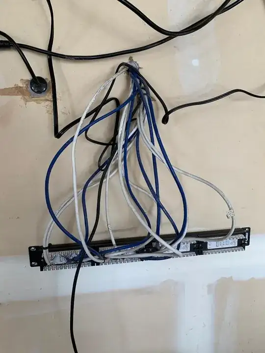

And here is the patch panel (Yikes, I know. Secondary question will be how to figure out which cable in this rat's nest goes where)
Patch Panel

Step one - if the roof antenna is gone, and you are not otherwise using the existing cables, remove the power injector. It's just wasting power and doing nothing useful, and may be incompatible with whatever you do next. It is at minimum irrelevant, or else it is doing something and you'll notice something like video cameras stop working and revise your assessment of your system wiring.

I cannot make out from the small picture what obscenity has been done with what appears to be a rack mount patch panel in the garage that's either hanging from the wires (bad, bad, bad idea) or screwed to the wall in what would appear to be a direction that would make the patch ports inaccessible, normally. You can get a small wall mount rack to clean that up rather inexpensively, or even do something creative with blocks of wood and screws that would be better than what little I can infer from the picture.

Anyone notice those silver screws bolting the supposed patch panel face first to the wall?
I don't think that patch panel is what you think it is.

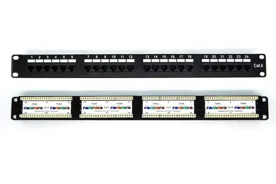

It looks like something that splices together pairs of ethernet cables. Not something that provides rj-45 outlets (a patch panel). These are more common in telephony where the telephone company comes in on the bottom, and your outlets go out on the top. It's not really used much at all for ethernet networking.
BUT you can salvage the situation.
First, make sure it's not actually a patch panel: actual patch panel bolted uselessly face first to the wall by taking it off the wall and checking for rj45 ports.
Then you can either buy an actual patch panel and a pushdown tool, and transfer the wires to it. (Remember to trim each wire 1 inch first, untwist, and push down a fresh spot on each conductor. Do not take the easy way out and try to reuse where it's already been bitten. The push-downs depend on the malleability of copper to make a good connection by deforming it during the push)
