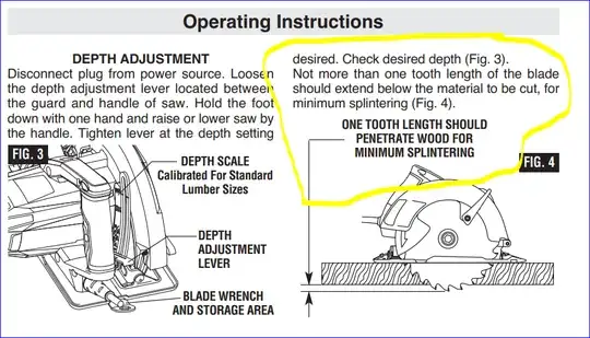

Skil gives two reasons for it.
From the operating manual for a Skil brand circular saw:
"to minimise splintering"

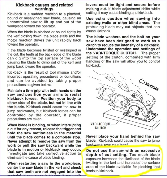

and in the "kickback" warning section:
"to reduce the chance of kickback"
