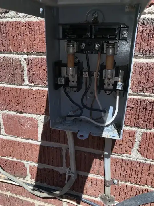

Presently I have a 30A 240VAC fuseable pullout switch (Eaton DPF221R) fed by a 30A breaker in my service panel. My contractor quoted $250 to replace the outside disconnect. Separately, he requested a 240V 20A supply for the mini-split.
Based on answers so far I’m leaning towards a #6 home run on a 2-pole 50A breaker to the existing interior junction box. From there I would run in conduit to two outdoor disconnects: the existing 30A fused disconnect (with 20A fuses) for the mini split and a new 60A fused disconnect with gfci outlet (and 40A fuses) for the central air.
The existing disconnect is in good order but the exposed UF will need to be corrected. Existing 30A fused disconnect

Keeping what you have You will need 2 home runs because the smaller unit has 20 a max.
I might do it with a single home run and install a nema 3r load center, this is one of the cases where small is ok, I think a 6 position 75 amp panel will do what you need. Including a 120v receptacle I don’t see one in the photo.
I don’t know if you will get away with the exposed UF outside that should have been in conduit as it was exposed. Below 8’
Run the small load center and pay the 12$ for the lockout devices and that can be your disconnecting means (I did this at my home) and this load center will have enough room to feed the 120v outlet. Look for spa load centers this is the style I have used for this same type of job.
Note the lockout devices must be permanently mounted and you need GFCI breakers make sure you get one that the breakers are not as much as the panel.
