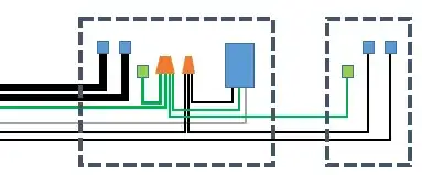

The wiring would go as follows:
  • Central AC: 60A fusible NEMA 3R disconnect (with 40A RK5 fuses), #8 THWN to internal jbox, 8/2 NM-B to service panel with 40A 2-pole breaker.
    Minisplit + GFCI: 30A fusible NEMA 3R disconnect (with 20A RK5 fuses), #12 THWN to internal jbox, 12/3 NM-B to service panel with 20A 2-pole breaker. GFCI outlet either integrated in disconnect panel or in separate weatherproof box.

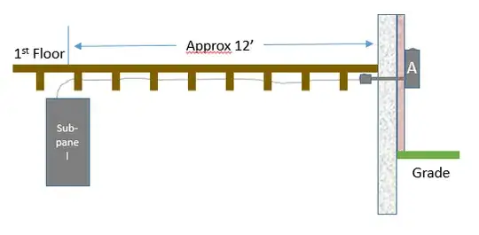

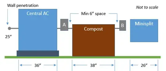

I will run #10 Cu ground wire. All THWN to run above ground in shared conduit thru and along outside of brick wall under an eave in Virginia. For ampacity, no temperature correction has been applied but 5 current-carrying wires in conduit calls for an 80% adjustment. For conduit fill we have 2@#8 (0.213), 1@#10 (0.161), 3@#12 (0.128). With 3/4 SCH 40 PVC conduit I estimate less than 30% fill (I am permitted 40%).
Any comments or concerns about this plan?

From sub-panel to outside From sub-panel to outside
Along the outside wall Along the outside wall
A rough wiring schematic Two disconnects shown as dashed boxes with GFCI outlet and lugs for fused circuits and ground.
Wiring schematic
