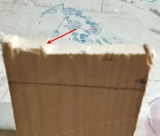

I attempted to test-cut a straight line using my new electric jigsaw. Therefore, I clamped a piece of scrap wood and used another piece as guide, marked the cut lines using a pencil and fitted the jigsaw with the blade and cut.
But my cut is like this:
Final result on jigsaw cut
As you can see, my cut is not straight and has some kind of stair-like pattern, so do you think that this blade used to cut is at fault?

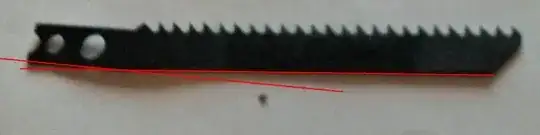

Jigsaw blade
Would you recommend this blade for cutting straight lines?

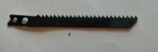

Blade for recommendation

You can cut straight lines and generally you followed the correct procedure - using a straight edge. Your picture of the cut is pretty blurry, so it's hard to tell for sure, but there are several possibilities:

  • It does appear that your blade has a lower tooth-per-inch count. I'd guess it's between 6 and 9 teeth per inch.
    • These blades are good for "general purpose" cutting and especially for fast cutting. They generally do not make a "pretty" cut. They generally leave a pretty ragged cut edge behind.
    • If you want a smoother cut, a higher tooth-per-inch blade is what you want. Something that has 12 or more teeth per inch. Be aware, however, that these will cut slower, and are often designed for cutting metal. They will cut wood just fine, but they will cut slowly in comparison to the faster cutting wood blades.

Finally, it looks like your "option" blade is labeled "extra clean cut". That will help make a nicer cut, but what you really want is a wider blade - one that has more distance between the points of the teeth and the smooth non-cutting side of the blade. This width is what will help the blade track straighter, though it still isn't the magic bullet for straights cuts.

The blade looks bent. I've drawn lines along the spine of the blade as shown in the photo in the question. If we assume the background is flat, the point where my red lines cross isn't sitting on the surface, and is bent towards the camera. See also the shape of the shadow, and the non-round holes. On a non-flat background, it's possible the blade has been bent towards the teeth, but that would mean pressing very hard backwards without buckling it.

Step 1: don't start with a bent blade, instead buy a new one. Bent blades are more likely to break and won't cut straight. If the blade bent during cutting, you were pushing too hard, and probably sideways.
