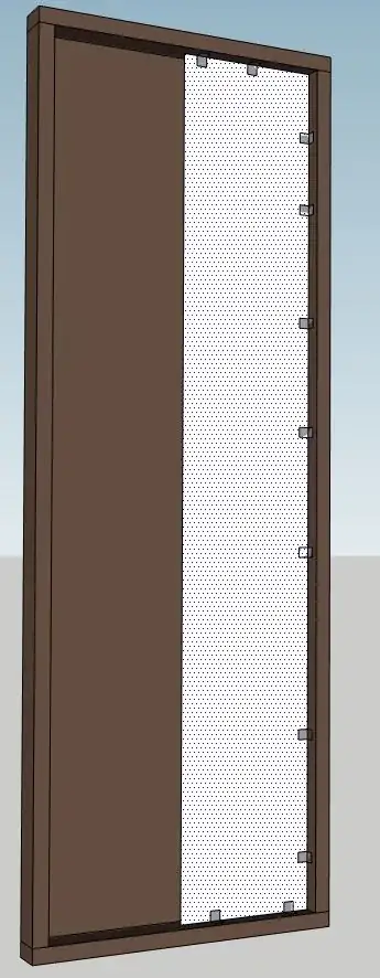

What I want to do is hang the pegboard inside the 'box' made by the studs, so I can inset it 2-3" (most instructions I'm seeing say you need 1/2" behind the pegboard). It's a small shed, and the 2-3" of extra space I would get by having things hang between the studs would be welcome.
I figured I would just use corner braces, bolt them to the pegboard and screw into the sides of the studs and crossbeams (was thinking 1/2" screws, so I could hang on both sides of a given stud), but I couldn't find examples of anyone doing that, so I wanted to make sure it wasn't a bad idea. Is that going to be too weak?
Here's a diagram of what I want to do - the pegboard would fill the whole 'box,' but I cut it halfway so you can see it is offset from the back. The braces are just on there willy-nilly for illustrative, not planning, purposes.
pegboard hung inside studs

Yes, you can place pegboard between studs, but as you stated, you need some clearance behind the pegboard. You could use 1x1 attached to the side of the studs to screw into. This will give you better holding power than brackets alone.

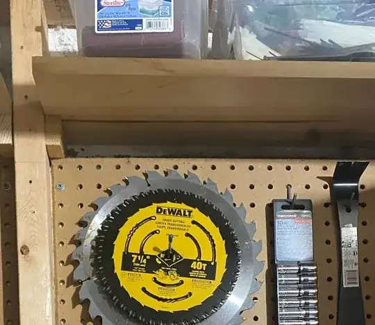

When I did mine, I used 1x2, but I screwed them in across their width, so I'd have more surface area to screw to. My studs were not exactly spaced and straight so I needed a bit more area to attach.
No glue in my opinion. My garage
