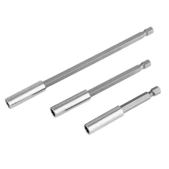

There is of course a proper tool to extend a hex drill bit to go into hard to reach places:
This is more practical than carrying a set of 30cm drill bits, and it'll work with the small diameter bits too. If you pile up enough extenders, the assembly has enough flex to drill or screw right up to the wall without hitting it with the chuck... and it's still rigid enough to be controllable.
