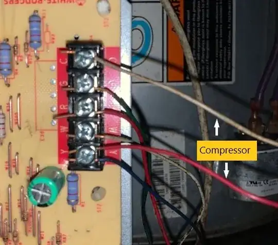

First, here is my current HVAC control board setting as below.
my control board

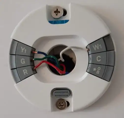

And, here is my current setting with my Nest without C-wire:
Nest Thermostat E setting

Just follow the yellow brick road to your C terminal
Based on the fact that you have a two-wire cable apparently running out to your compressor based on the fact one wire of the cable is landed on Y, we can find your C terminal easily. In order for the air conditioner to come on when called, its contactor coil has to connect between Y and C as the thermostat applies 24VAC to Y to call for cooling. So, the other wire from the compressor cable must connect to C, and looking at the labeling on your control board, lo and behold, it does! Furthermore, HVAC terminal blocks are designed to have 2 wires under one screw, on opposite sides of the pressure plate, so the fact there's a wire already there is no obstacle to your plans.
From there, it's no different than how the videos describe it.

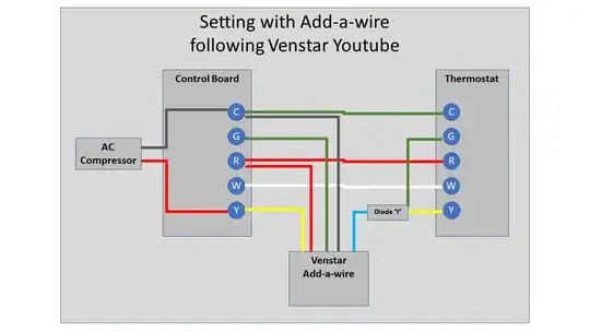

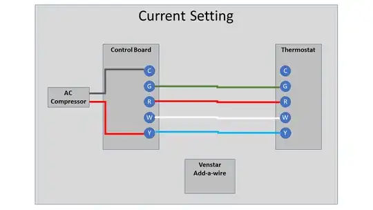

I depict the diagram based on ThreePhaseEel's suggestion below. The first image is the my current setting, and second image is the one with add-a-wire by ThreePhaseEel's answer.

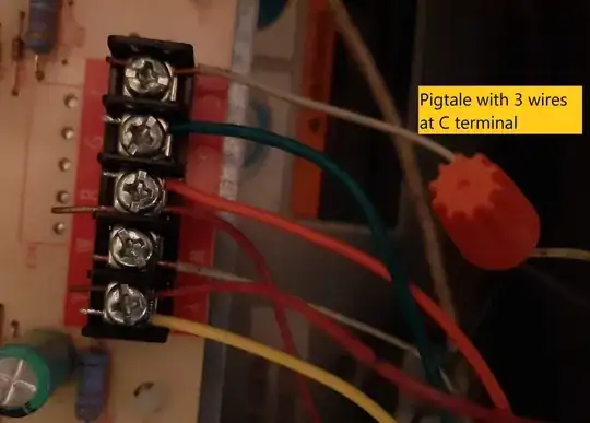

Also, I had a question about three wires on terminal C. According to the @ThreePhaseEel's answer and the post (How many wires can be connected to the C terminal at the furnace?), I implemented the setting and tested. Heating, Cooling, and Fan all works well.
The following image is the final result. Note that I did a pigtail with 3 wires at C terminal.
Thank you again, @ThreePhaseEel
