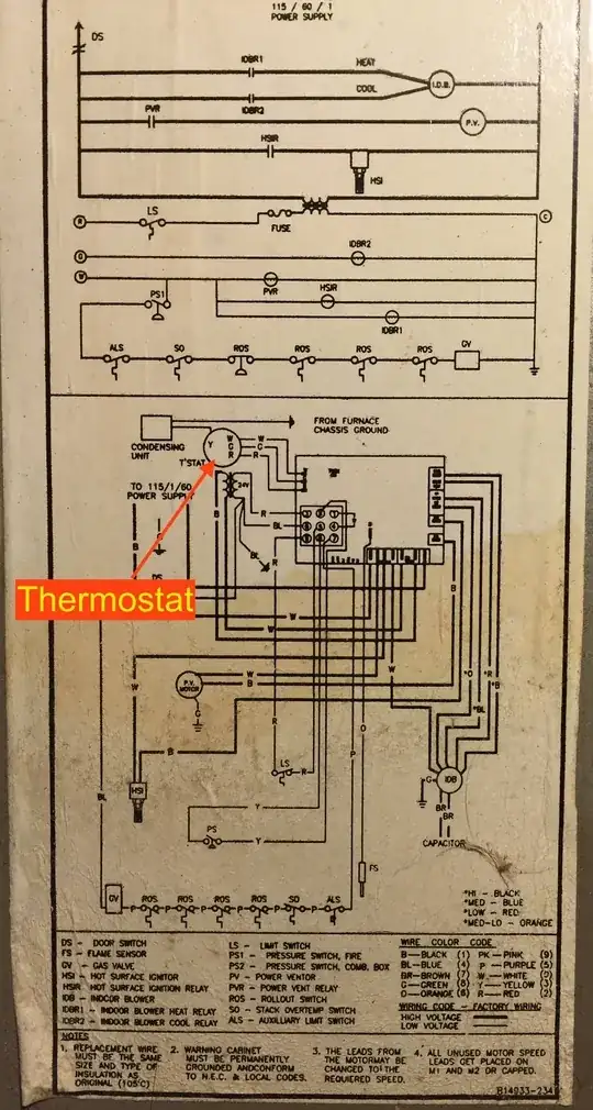

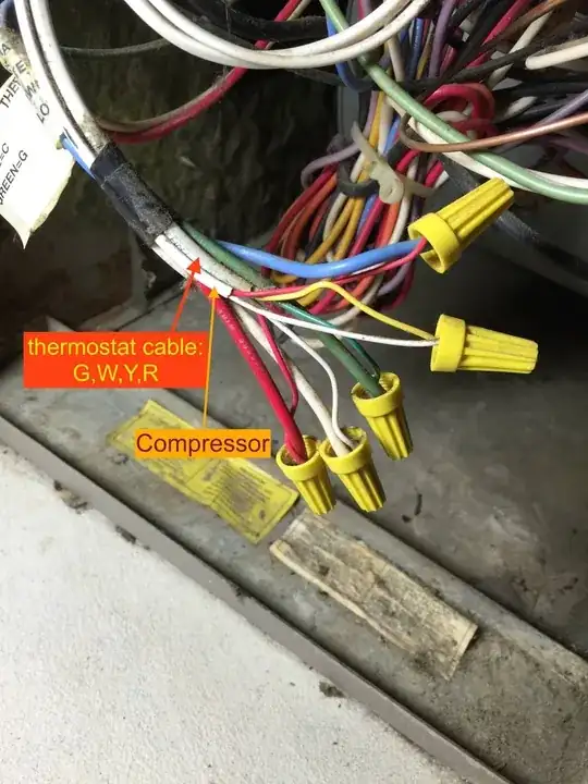

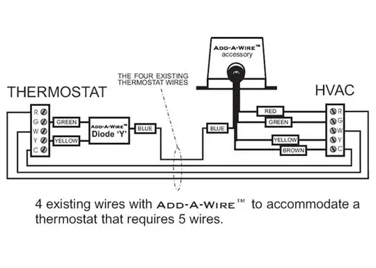

I want to add 5th wire to my HVAC control with the Add-a-wire gizmo. Conceptually I understand their instruction diagram, but not completely when it comes to my HVAC layout. The HVAC is single stage forced gas heat and AC, currently controlled by a 4 wire thermostat. All very standard. But what do I do about the yellow wire? On my unit instead of being nicely tied to appropriately labeled terminals, the compressor is fed directly from thermostat's yellow wire. I was hoping someone experienced with these systems can dumb it down for me.
HVAC diagram wires at the HVAC official add-a-wire diagram

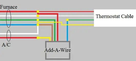

You'll start by wiring the furnace and A/C as follows:
  • Red from the furnace connects to Red from the thermostat cable and Red from the ADD-A-WIRE™ device.
  • White from the furnace connects to White from the thermostat cable.
  • Green from the furnace connects to Green from the ADD-A-WIRE™ device.
  • Blue From the furnace connects to White from the A/C condensing unit, Brown from the ADD-A-WIRE™ device, and Yellow from the thermostat cable (this is C).
  • Red from the A/C condensing unit connects to Yellow from the ADD-A-WIRE™ device.
  • Blue from the ADD-A-WIRE™ device connects to Green from the thermostat cable.
ADD-A-WIRE™ Furnace Wiring

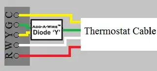

Next you'll connnect the wires to the thermostat as follows:
  • Red connects to the R terminal.
  • White connects to the W terminal.
  • Yellow connects to the C terminal.
  • Green connects to the ADD-A-WIRE™ Diode 'Y'.
  • Yellow from the ADD-A-WIRE™ Diode 'Y' connects to the Y terminal.
  • Green from the ADD-A-WIRE™ Diode 'Y' connects to the G terminal.
