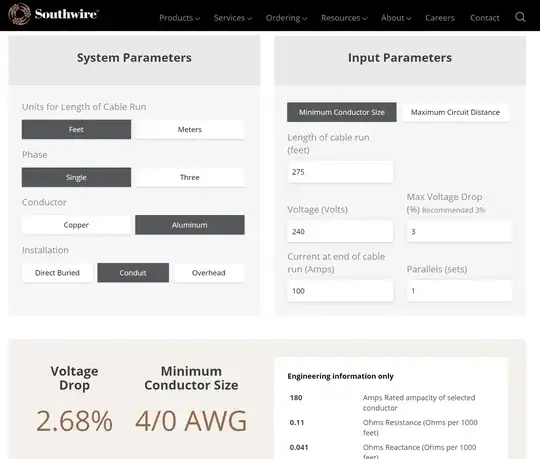

I don't get your 1 AWG figure, however. Using the Southwire calculator at:
Southwire Wire Calculator
returns a recommendation of 4/0 :

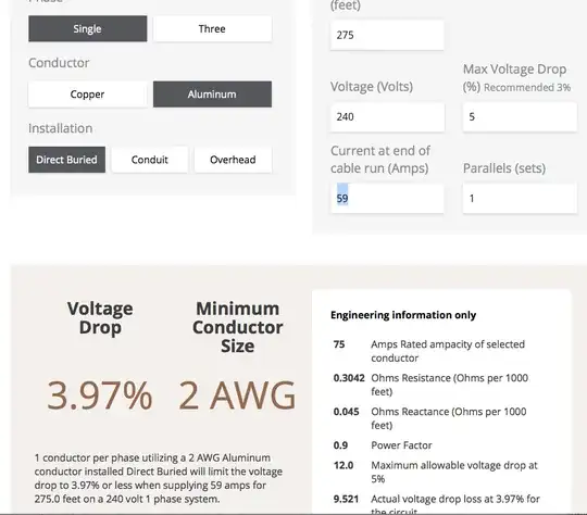

Into the calc we go. I crunched the following:
#2 at 3.97% drop. That's good enough.
You're planning to go #1 Al anyway, which gives you 3.28% drop at 59A which is fine for your expected and likely future needs.
