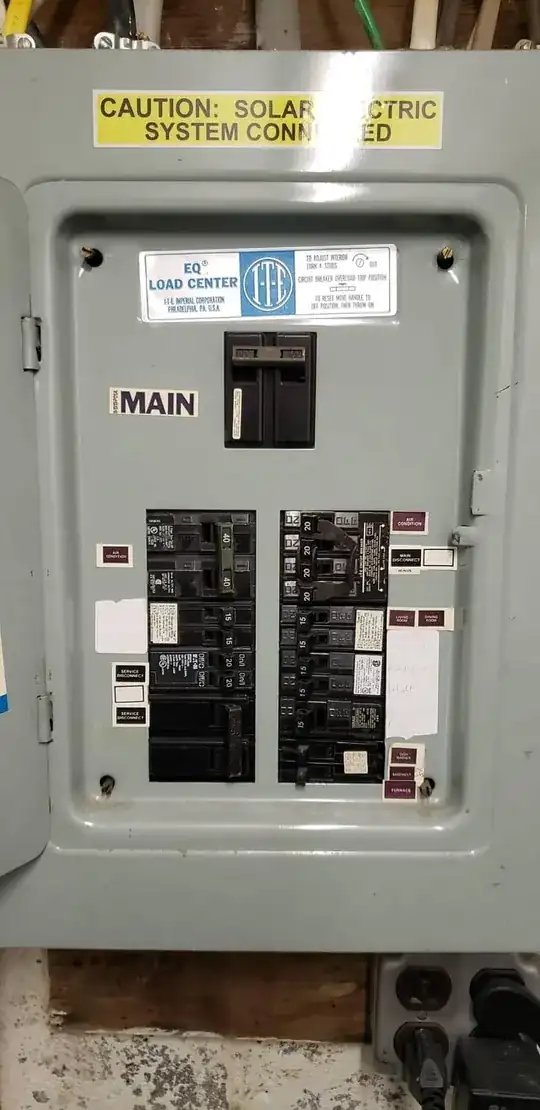

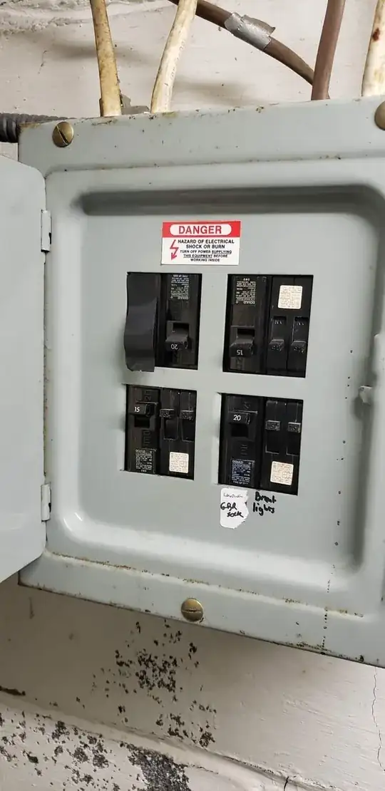

Photos (click to enlarge):
Current Sub Panel
Main Panel
Small Extension Panel beside Main panel

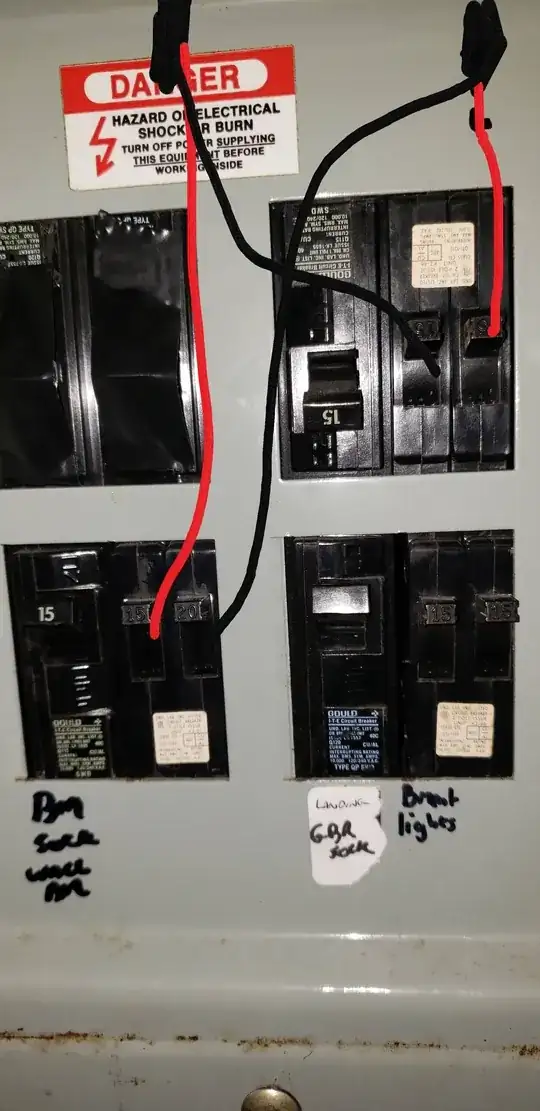

The plot thickens lol (im ditching the oven circuit for now for ease of understanding but will likely look at full upgrade anyway)
So turns out in the sub panel off the main panel there is a cable for the dishwasher and washing machine already! So i figured as the washing machine one goes over the same area of the basement i want to move the laundry room too i could pull it down and use it but now it gets odd. It seems like (from my research) this is wired as a split phase shared neutral (as per here: Term to describe two circuits run through one /3 cable) and in the receptacle i can see an entry and exit wire so i assume the exit wire goes off to the dishwasher. The wiring in the panel is odd. There seems to be 2 double pole breakers, one is 15A/15A the other is 15A/20A! The wires are split between them. Is there any easy way these can be split back to single dedicated lines? (excuse my horrific diagram)

Well we don’t add breakers for the total. Your example a 30 amp feed with a 30/40/50 amp oven and a dryer would exceed the load calculations for a 30 amp feeder this is true a 50 amp oven alone would trip the 30 amp breaker if both elements were on. But I could put 5ea 20 amp 120v circuits and be fine even with the total being 100 amps of 120, how could this be? The actual load is what is used in the calculation and don’t forget 30 amps at 240 is 60 amps at 120.
Now to see if you can use some of your existing gear to do what you want. Check the size of existing sub panel if it is 60 amp or greater it is likely you can upsize the wire and breaker from the main (I would keep the gas dryer).
if you go with a oven at 40a or smaller a 60 amp sub could do this with what you have listed with the gas dryer.
Where you could run into problems is the 100 amp main with gas heat dryer and oven 100 amps is a no brainer.
But convert these gas over to electric and your service will need to be upgraded here is an example of the ovens I have measured they run ~38 amps, dryers 24 amps and both of these are 240v loads so right there you are at 62 amps of true load, add another 13 for lighting and outlets (13 amps each leg) in this “small area” and you are up to 75 amps of load at that level most electricians would be adding a 100 amp sub. Is the rest of your house only drawing only 25 amps? So with all you want sure it could be done and if you want to learn and your state allows it you can add the sub.
Many states allow you to even set your main panel. With code updates a new main panel that turns your existing main into a sub may be the best route, then pull from the new main or old main to feed the new area sub. Or sub of a sub.
Your question is quite broad and I tried to give you the info needed to decide if you can do it or hire it out

I think you already know the answer to this. While panels can be over-subscribed, what you are asking about is just too much. To put those loads on the sub-panel would probably also require upgrading the feed (wiring) and breaker from the main panel, as well as replacing the sub-panel. You didn't say how many spaces are available in the sub-panel, but I would guess not very many.
Would it be possible to put the largest loads (Range and Dryer) on the main panel? The runs might be longer, but at the end of the day, might be your least expensive option.
Pics and brands of the gear are helpful. IE: If it's zinsco panel, we'd have completely different advice! (LIKE RIP IT OUT).
George Anderson
  • 23,304
  • 83
If a "30/40/50A Oven" cicuit is contemplated, a 30A panel can't supply that unless it's the only thing and 30A, not 40 or 50.
Honestly, with the amount you are proposing to provision, it seems dubious that your main panel at 100A has adequate power to spare, so you might be looking at a service upgrade if your incoming service is only 100A and you have "normal household loads" on that already.
You could quite reasonably consider a 100A subpanel, if you had power to feed it - that will (probably) require a service upgrade, and definitely require an upgrade of the wiring to the subpanel location and the subpanel itself.
