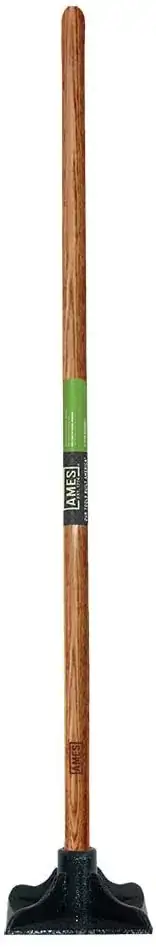

This is what is being compacted when you see a worker using a motorized tamper on a job site. If you'd rather not rent one a similar tool can be employed with out the motor:
Manual tamper
You should layer and then tamp the fill sand. This can be expedited if you wet the layers occasionally. Not to saturated, but enough to start settling the sand. The most important area to compact is beneath the pipe so you may want to plan ahead by determining the location of the new line and placing the fill first.
Compact until the sand is almost above the pipe and than cover with loose fill. Afterwards native soil can be used to fill the remaining trench.
