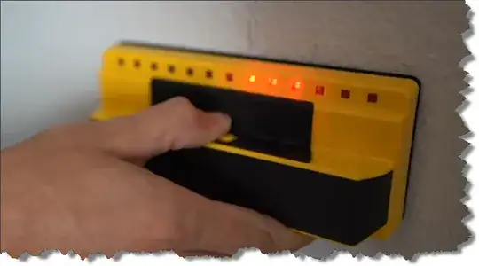

Def. use a stud finder. I have something like this and it also alerts me to electrical cables. Like another poster said, just sheetrock is NOT strong enough to mount a TV to. You'll end up with a ripped up wall and a crashed TV at some point.
wide stud finder
