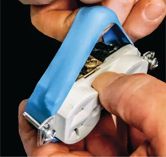

So I go against the grain on this, I think it's OK to wrap your devices with tape. As mentioned in another answer, don't use junk tape. The only ones I have seen with the necessary stretchy-ness is 3M brand 33 or 88. Apply a little tension when you wrap and these will form nicely around the bumps and etc.
The only problem with tape, besides the disdain of misguided professionals, is the mess the residue makes. Ideal Industries has a new product that solves this, Armourband:
Ideal Armourband
It's a broad flat elastic band that stretches around the device to protect the terminals. So if tape residue is an issue for you, there is an alternative.
