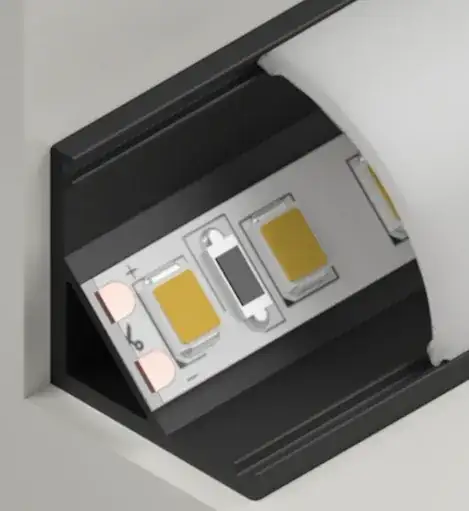

I'm asking because I'd like to use a 16mm 45-degree channel like the one pictured below, and I believe that this channel is IP60, meaning "not water-resistant". I've seen 45-degree channels claiming "IP65 with the right sealant" but those channels are taller: at least 19mm. Even the 16mm enclosure is quite noticeable, so I'd like to I'd really like to avoid taller ones if possible.
