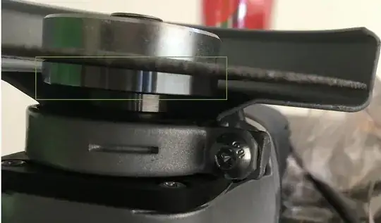

I have repeatedly faced hurdles removing/replacing blades on my (two) grinders. I do have the two-prong tool to turn counterclockwise. But usually that's not sufficient. The underside apparently needs to be vice-gripped - according to comments from another question How to cut rebar with an angle grinder- I presume in the green rectangular area ?
I don't have any wrench that fits that description that is both:
  • wide enough ~2 inches
  • thin enough to fit below the blade and above the lower nut/bracket
How have folks done this: is there a special wrench for this - or other approach?

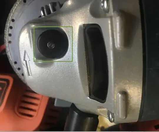

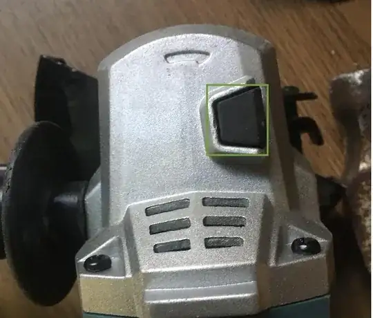

Hand grinders have a button to lock the spindle to remove or tighten a grinder wheel. It is usually on the housing above the wheel. Usually just a push button, that pushes a steel rod into a hole in the spindle, to lock it from turning. For safety should unplug grinder from power when changing grinder wheels.
Original Poster here I am adding a picture of the spindle lock to this accepted answer for full clarity.
No Name Grinder
No Name Grinder
Bosch Grinder
Bosch Grinder
