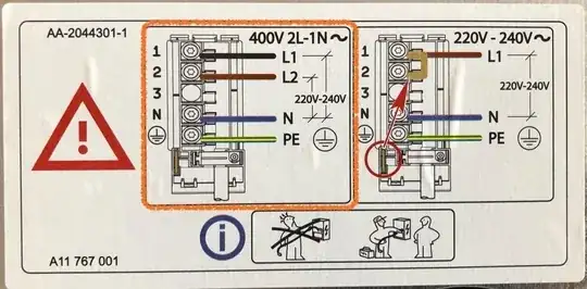

I need to replace an induction hob that has been broken with another of the same model (IKEA Matmässig, just for sake of completeness).
Original connection options
The original connection to the mains was made according to the highlighted scheme below, 400V 2L-1N, corresponding to the two-phase set-up that is very common in the Netherlands.
2 live 1 neutral wiring
The only difference is that the connection to the Neutral terminal uses both the blue and grey wires to the Perilex-type plug. On the plug itself, the grey wire corresponds to the L3 pin. However, the actual supply to the socket is two-phase, and the pole corresponding to L3 on the socket has 0 volts on it.

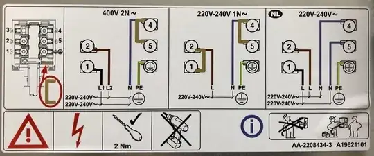

The new version of the hob is slightly different. The connection options include a 400V two-phase connection scheme, and an additional scheme for the NL. It seems to me that either of these would work fine.
My questions:
  • what's the actual difference between the first and third schemes shown below?
  • if the Perilex system has a pole that is sometimes live (three-phase) and sometimes neutral (two-phase) isn't that a potential for unfortunate misunderstandings?
IKEA Matmässig connection options
Actually, the common 400V 2 phase setup in the Netherlands is 2L-2N with the second neutral on what you indicated as the L3 pin.
And it is not even a proper 2-phase, but rather 2 single-phase connections joined together.
The difference is that you have 2 neutral wires that may need to be balanced against the corresponding live wire in the amount of current they are carrying, versus a single neutral wire.
With the old hob (and the left wiring diagram on the new one), if your panel has two GFCI-type circuit breakers that are tied together to supply the hob, there is a chance that both breaker independently measure a dis-balance between the current supplied on the hot wire and the current returning on the neutral wire and conclude there is a ground fault, when in reality some current is supplied on the live wire of breaker 1 and returning on the neutral wire of breaker 2.
With the right wiring diagram of the new hob, the hob can ensure that current arriving on L1 is returned on N1 and correspondingly for L2/N2.
The hob is wired so that the current on terminal 1 is returned on terminal 4*, and the current on terminal 2 is returned on terminal 5*.
Therefore each hot wire returns its current on a separate neutral.
That is very important if a house is wired single-phase with both hots at the same phase potential (0 volts between them). If both tried to return on the same 1 neutral wire, it would overload that neutral wire.
"But it wouldn't be 1 neutral wire, it would be 2 neutral wires paralleled!" Are you so sure? Who's to say one of those neutral wires hasn't broken or had a poor connection? What you want, if a neutral wire breaks, is for the hob to quit working so the human goes and fixes it. If one neutral wire fails silently, the other one overloads silently. That's why paralleling isn't allowed (without exotic protections such as fusing).
Obviously this doesn't matter if the 2 hots are on different phases. But this allows phases to be rearranged without worry.
* or these, reversed.

I was able to find some additional information, so I will add this here.
Most importantly, the arrangement I have, with two live and two neutral terminals in the socket, is not two-phase. The live terminals are on the same phase. It's just a way, used in the NL, to deliver more power to the appliance.
Although the socket and plug are Perilex units designed for three-phase power, this arrangement is a non-standard but very common use of it in the NL.
Each installation of this kind is a one-off - there is no standard for which pins are live and which are neutral. That means each appliance connected has to be wired up for that particular installation.
