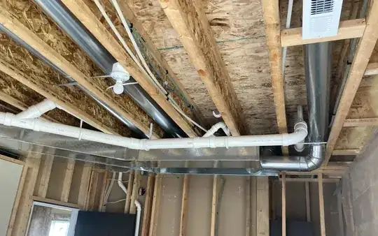

In the process of finishing my basement and one of the rooms has mechanicals on the ceiling. Because these mechanicals cover ~40% of the ceiling I want to frame and drywall the entire ceiling at the same height as opposed to a box around the mechanicals. The lowest point of the mechanicals 8' 3 1/2" Hoping to have an 8' finished ceiling height. What type/dimension wood should i use to frame the ceiling? How should it be fastened to the I-Joists above?
Ceiling with Mechanicals

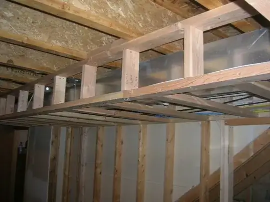

In your scenario, I would build a bunch of "soffit ladders" and run them perpendicular to your floor joists.
You should use 5/8 drywall. I would put just one layer. 2 layers is unnecessary unless you have a permit and the building inspector requires it. You can then space the ladders at a max of 24" on center, 16" if you wanted to over do it. Normal 2x4s will be fine.
If you run into a pipe or any obstruction, just stop the ladder before and continue it after or build the ladder around the pipe and have it run through the ladder.
As long as all edges of the drywall can be secured and you can fasten every 24 inches within the drywall, you will be fine.
In the below picture you can see the vertical soffit ladder, I wouldn't worry about running 2x4s between the ladders, unless the ductwork prevents you from putting a ladder on the 24" mark.
