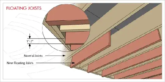

To clarify, this image is roughly what I'm planning for, where the red joists are to be added and whose dimensions I'm trying to determine.
Staggered Joists

Old I know but worth it: Lee Stan has the right idea but, To answer your question more directly - ****The joists should be AT LEAST 2x6 and can be mounted or hung lower than the rafters using joist hangers.
Note the joist width is entirely dependent on your local codes for your span. California is different than others for example

I've seen a 2x4 drop ceiling with a 14' span and 1/2" drywall below a bedroom, and that seemed fine, but the deflection calculators online tend to indicate that 2x4's might be marginal, and 2x6 should be used, especially if they are only hung at the ends and no support along the span, as might be needed to reduce sound transfer. Either 16"or 24" centers, whichever is more convenient.
If it were my project would probably do Roxul against the subfloor above, hang new 2"x6" on 24" with joist hangers and bracing between the new joists, then resilient channel and 5/8" or 1/2" drywall. Electrical boxes can be covered by Roxul as well, or more sophisticated sound deadening membrane. Also, any penetrations in the floor above for pipes should be sealed around with something like a latex caulk.

After reading more of what you want I would use 2x6" for the span and 16" centers with hangers this would be enough to support the ceiling and even recessed lighting like this. hung at the bottom this will provide the isolation you are looking for. We use these hangers for supporting overhangs with sheeting and roofing all the time and for decks. I would hand select the boards to get the best quality #2 or better but if you can afford #1's because today's lumber is not of the quality it was 20 years ago because of the smaller trees.
