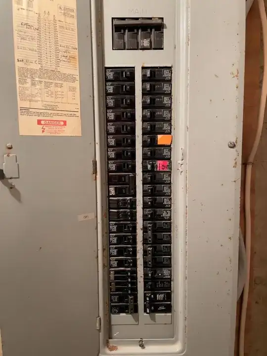

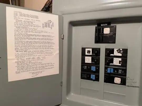

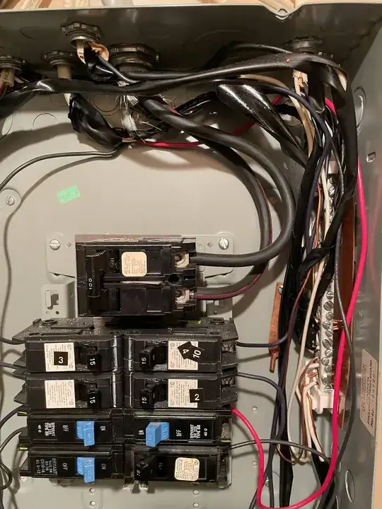

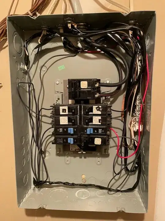

The main panel is 200A, the sub-panel that will feed this line is a 100A sub-panel. On it are already 8 - 15A breakers, one for low voltage (I believe these are on the ground outside lights), the other 7 breakers are all for lights and outlets in the basement. The basement is finished (but really needs to be redone), more significantly at least for now is that the basement is largely if not entirely unused. It was pointed out to me that a) there's probably not enough capacity in the sub-panel to pull anything more than 60A, and b that the wire feeding the sub is probably a #6 and so there's no point using a bigger wire to go out from the panel.

The existing subpanel and feeder
The main panel is 200A, the sub-panel that will feed this line is a 100A sub-panel. On it are already 8 - 15A breakers...
OK, so the existing subpanel (not at the garage) has a 100A bus or main breaker. You have reported that its feeder wire is #2 aluminum. This is rated at 90 amps.
At some point in the future, you might want to upgrade that feeder to something larger, and maybe even upgrade that subpanel to something larger. But for now 90A is fine.
Since you have 8 circuits in the panel, you need to leave some ampacity for them. Keep in mind that a) they are spread across 2 phases, and b) they will never be maxed out at once. The Electrical Code recognizes this, and doesn't require you to allocate a full 60A of feeder capacity for them - far less in fact. Allocating 25-30A for all 8 circuits is within reason. That leaves 60-65A you can pass on to the EVSE.

I would take a look at that #2 feeder to the existing subpanel - the one with eight 15A circuit in it. Since that is the bottleneck.
I would want to change out that subpanel and its existing feeder. The subpanel to one with 200A busing, and lots of breaker spaces (I like breaker spaces - they're cheap, and having them saves big trouble later).
And upgrade the old #2 feeder to probably 2/0 size, which allows running 135 amps. (the largest practical breaker size is 125 amps, so that works fine). That would let you provision full 90A to the garage feeder, while having an ample 35A in reserve to cover the needs of the eight 15A breakers.
