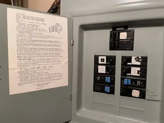

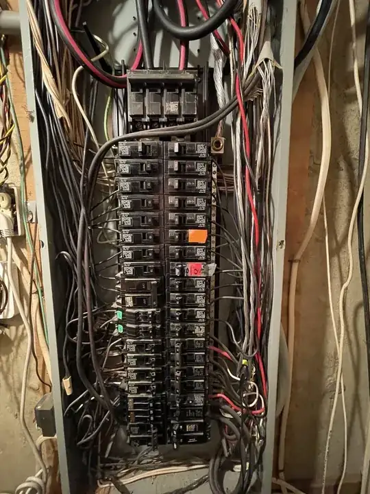

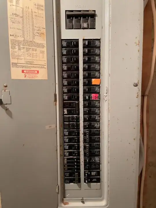

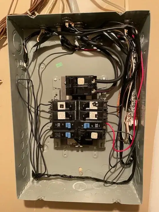

First, high res pictures of my panels:

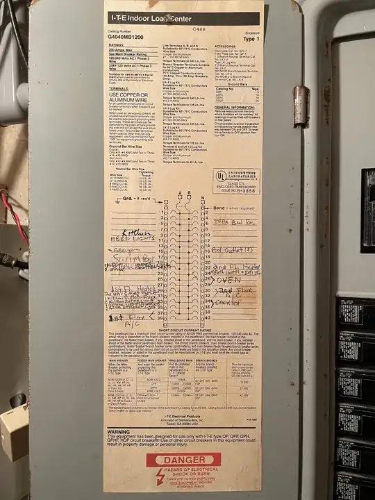

Main panel: main panel with door open
Main panel inside: main panel inside
Main panel updated 2x label(s): enter image description here Sub panel: sub panel with door open
Sub panel label on inside of door: sub panel label on inside of door Sub panel inside: sub panel innards 1 and sub panel innards 2.
The wire from the main panel to the sub says: "Alcan S Stabiloy AA-8000 Series U Type XHHW CORS 600 Volts 2 CORS 2 AL 1 COR 4 AL (UL)".

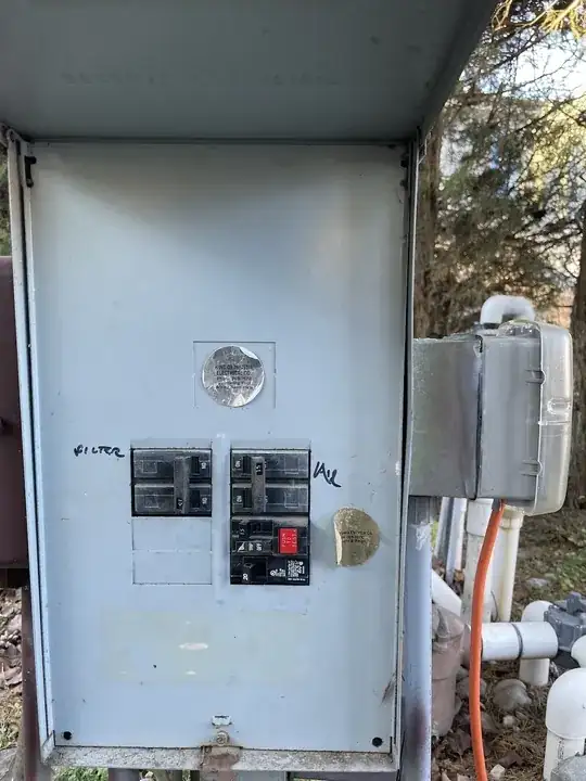

Pool sub panel: pool sub panel

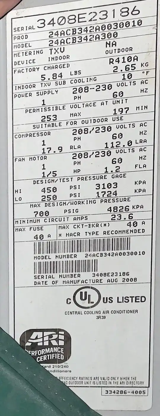

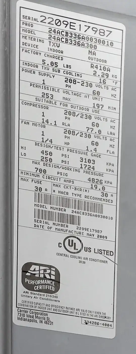

A/C units labels:
A/C unit #1: Bigger A/C unit - guessing 1st Fl
A/C unit #2: Smaller A/C unit - likely 2nd Fl

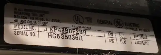

Double Oven label:
MAIN PANEL:
200A MAIN.
100A (bottom right - breaker #38-40) - feeder wire to sub-panel.
50A - 1st Floor A/C (bottom left - breaker #77-39).
40A - 2nd Floor A/C (breaker 30-32).
40A - Oven (breaker 26-28).
20A and another 20A (not dual pole breakers) - Cooktop (breakers #34 and 36).
20A - 1st Floor Heater (breaker #29).
20A - 2nd Floor Heater (breaker #22).
30A - Swimming pool (breaker #17-19).
20A - Office (breaker #21 - skinny dual pole 20A).
20A - Kitchen Countertop Outlets (dual-breaker #33, both breakers control different walls of outlets in the kitchen).
20A - MasterBathroom heated floor and one GFCI outlet, but not two other walls of outlets (breaker #24).
20A - (Breaker #35) - top is outside lights (4 front door walkway posts, 4 driveway posts, two spot lights on the ground); bottom is lights only, not outlets, for one side, roughly half or smaller, basement. Very likely it also covers an outside outlet right by front door and those front door walkway lights).
So above are all or almost all breakers 20A and above. Unfortunately not everything is labeled. House was built in 1987, we're second owners for 3 years now. Other things labeled on the main panel are:
15A - Kitchen (breaker #9).
15A - Master Bedroom lights (breaker #11).
15A - Garage (breaker #13) there are overhead lights - two florescent long tube fixtures, two garage door openers with their own two bulbs each, a regular outlet and another quad outlet; there's also a second fridge in the garage.
15A - "2nd Fl Bed Room" (breaker #6)
The rest is unlabeled unfortunately, but with the updates below, also reflected above, I think I covered all but possibly one 20A breakers. Everything else is 15A and is either described above or unlabeled. I count 20 separate 15A breakers, in total.

Breaker #16 - this is the one with a weird red sticker, well I now think it says "pool outlet", which would explain why it would trip when I tried plugging a water removal pump into that outlet.

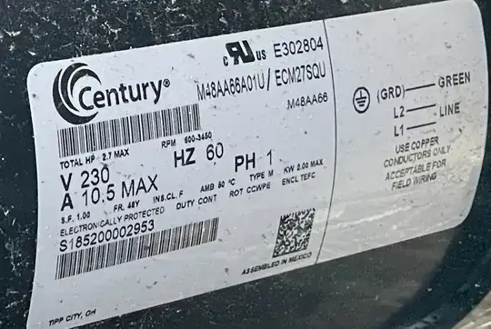

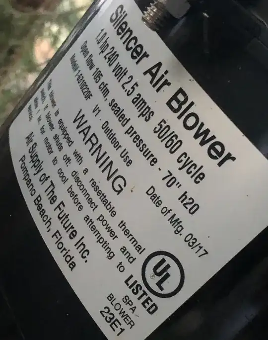

So the pool actually has another sub-panel, I'm adding a pic of it, but again it's all on the #17-19 30A breaker anyway, and the only things on there is the variable speed/efficient pool pump, a blower for the tub, and gas water heater - the pool pump is the only that the really gets used. I run an electric pool cleaner/robot off that outlet. I think back in the day there was a higher power vacuum being used here, and right 15A breaker is in the pool sub panel, but like I said, the one I use now I think is a lot lower power.
update 5:
Pool Pump motorPool Pump/motor
Hot tub blower Hot tub blower

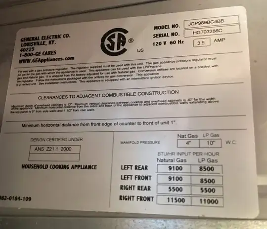

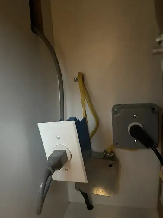

@ThreePhaseEel - regarding the two cooktop circuits, just tested and one controls the gas cooktop which has a kitchen exhaust-type fan built in; and the other controls the outlet (buried inside of the cabinet/space under the cooktop that has the microwave plugged into to it). CooktopCooktop
Microwavemicrowave
Connections for both (microwave plugged into the white face outlet, cooktop into the metal one): enter image description here

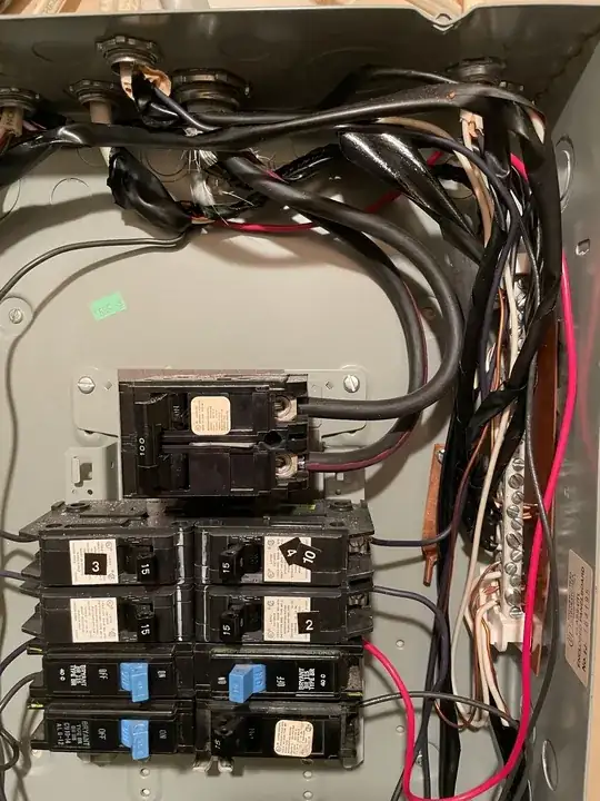

SUB-PANEL: As noted, the 100A goes to a sub-panel, which is right next to the main panel. The feeder wire between the two panels says: "Alcan S Stabiloy AA-8000 Series U Type XHHW CORS 600 Volts 2 CORS 2 AL 1 COR 4 AL (UL)". The sub panel has 100A main, and contains 8 separate 15A breakers (4 and 4 on each side, see pictures). One of the 15A is labeled as Low Voltage Lts - I believe this is for on the ground lights outside in the front of the house, some of these have been removed, there are currently like 2 working lights not the ground under one tree, and then four light poles around the driveway, and four walk-way lights along the path to the front door (not sure if you need to know all that). The other 7x15A breakers are unlabeled but from testing appear to all be for lights and outlets in the basement, which is finished but almost entirely unused.
HOUSE: 3,700 sq ft, not including the finished but largely unused basement, which itself is 1,664 sq ft per plans. 2 A/C units and 2 Furnaces (gas), as well as 2 Water Heaters (gas). Pool heater is also gas and rarely used. Pool pump is a new efficient variable speed motor that typically is used on low power Stove is gas. Separate dual oven is electric. Washer is electric, Dryer is gas. If it helps, I've replaced almost all the lights around the house with LEDs.

While your service isn't overloaded yet, that main panel is quite surely overstuffed!
Running a NEC Article 220 load calculation on your main panel, with 4 kitchen SABCs, the given square footage (including the basement), a 5kVA dryer, and the given oven and motor loads yields 38387VA, or just under 160A @ 240VAC. This is not yet an issue for your service; however, your main panel is badly overstuffed, with several double-stuff breakers present in a panel that does not accept any tandem/double-stuff breakers, never mind the several aliens that are present!
As a result, the first order of business is simple: replacing that main panel with a larger panel (you'd need to go up to a 54-space or 60-space loadcenter to do this), or alternatively fitting another subpanel next to the main panel and moving at least 4 circuits to it to evict the double-stuff breakers in spaces 21, 23, 33, and 35 from the panel. While this is done, the alien breakers in spaces 17-19 and 36 need to be evicted from the panel; the breaker in spaces 38-40 is also an alien, but we'll address it below as there are other things wrong with it as well.
That feeder, though, is overbreakered...
The other piece of bad news is that the feeder to the basement subpanel, while not at all overloaded, is overbreakered, as a 2AWG Al wire is only good for 90A at 75°C. This can be fixed by swapping the alien 100A breaker in spaces 38-40 for a Siemens Q290, or the correct type of 2-pole, 90A breaker for your new panel if you're going for a wholesale replacement.
And there's just not enough headroom for EV charging without upsizing the service as a whole
The final problem is that adding the 80A of EV charging isn't possible without a service upgrade, and would also overload the feeder to the basement subpanel as well were you to try to tap power from there. (The basement panel calculates out to about 15A right now, which is why the oversized breaker isn't currently a critical issue, but I wouldn't want to pull 95A on a 90A feeder on the regular, either!)
