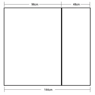

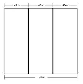

Design-wise, I am not sure whether I should be doing 3 boxes of 48cm width each or whether to do 1 x 96cm and 1 x 48cm.
I've seen a lot of folks online use 18mm MDF for the carcasses but I'm worried about potential sagging of a longer stretch. Would this be something mitigated by using melamine chipboard instead? Or is MDF the strongest and bestest to go for?

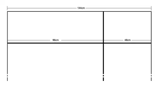

I am planning on making these full height with internal shelves at the top like:
Is this something that would also need consideration for sagging etc?
