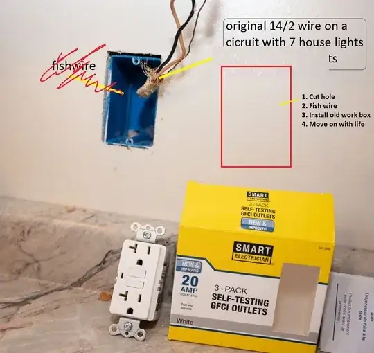

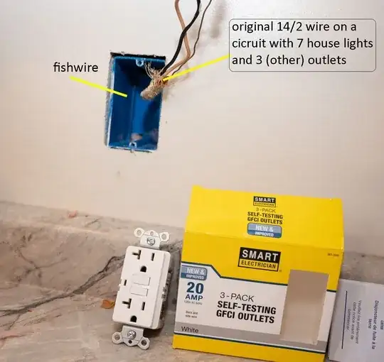

Original situation:

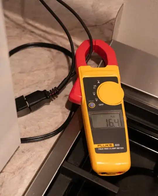

I have a 14/2 circuit, where the circuit powered 7 lights and 3 outlets. One of those outlets was in the kitchen and was powering a microwave and sometimes an air fryer. During microwave operation, the microwave sound started to sound lower in pitch occasionally suggesting to me that the circuit is overloaded or maybe that the microwave is going bad. I want to start at the circuit, because it is indeed underpowered for the microwave.
Appliance Usage
I usually use one or the other appliance, but not both. However, I might sometimes use both, but I imagine it will be rare, and so I don't know if it will be worth to wire up the circuit to account for using both, or using just one at a time. Also the way my appliances are positioned, both of them are plugged into the same kitchen outlet (the outlet in the photos).
Power stickers on the appliances:
  • Air Fryer: 1700W, 120 VAC, 60Hz
  • Microware: 60Hz, 11.5 amp, 120VAC
Note, however that when measuring amps directly the ammeter gave a reading of 16.4 amps at the highest for quite a while, and then it went down to 14 amp reading otherwise. I don't know if going from 11.5 amp to 14-16.4 amp is within the normal operating range of the microwave or if it is drawing more current because it is reaching its end of life or is faulty otherwise. I do plan to replace the microwave eventually.
Current Situation
I want to wire up a new outlet with duplex receptacles probably with 12 gauge wire that can handle both appliances. Chances are I will not run both of them at the same time, but there might be exceptions to where I do.
How do I best wire up this receptacle?
  • what AWG do I use?
  • what amp and type of breakers do I use, and where do I position them relative to each other?
  • what type of outlet do I use?
  • anything else I need to consider?

You've got a complicated issue here. You want to use a 20A circuit (which is required for new kitchen countertop circuits, so that is 100% correct) so 12 AWG wire. But you really want to be able to run two significant (> 10A) appliances at one time. You can't do that on a 20A circuit. There are two possible solutions:
  • MWBC = Multi-Wire Branch Circuit
    • Advantage: A little cheaper on wire, because you use one 12/3 cable instead of 2 12/2 cables.
    • Disadvantage: GFCI needs to be (practically speaking) at the breaker, which is more expensive than at the receptacle.
  • Two separate circuits.
    • Advantage: GFCI can be at the receptacle.
    • Disadvantage: Need two separate cables and two separate GFCI receptacles. (They can be in the same box side-by-side.)
An MWBC uses one neutral shared with two hots, together with a double-breaker (or two handle tied breakers, but double breaker is easier). The problem is that a shared neutral doesn't work well with ordinary GFCI receptacles, and a GFCI receptacle can't work with two hots anyway (you can't split it like a plain receptacle). But if you really want "a standard duplex receptacle with top and bottom each able to pull maximum current" then an MWBC is the way to do it.
Two separate circuits also uses two breaker spaces, but the breakers don't have to be next to each other. Each circuits needs GFCI but can use standard GFCI receptacles to do that. But you can't have the two receptacles of a duplex on two separate circuits unless you handle tie the breakers or use double breakers, and if you do that then you might as well save on cable by using 12/3 and then you have an MWBC.
Since you have easy access to run cables, I'd go with two separate 20A circuits, each with a standard 20A GFCI duplex receptacle. Mark one of them as "microwave". That way everyone knows "use the second receptacle of the duplex for small stuff like phone chargers but not for toaster or air fryer or other big stuff".

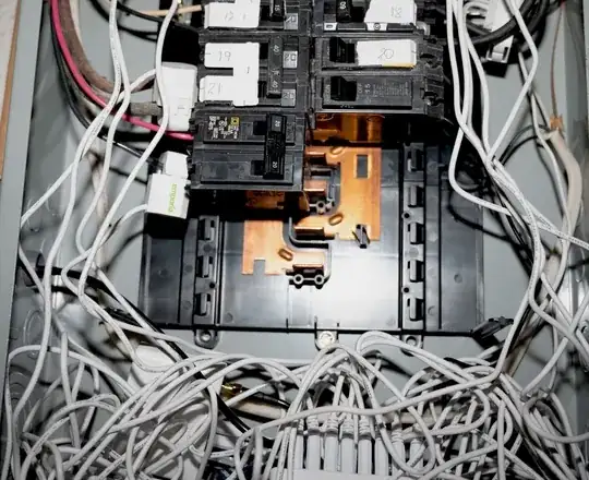

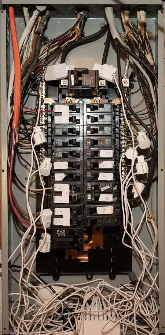

Alien breakers
This is plainly a Siemens/Murray panel, noting the un-plated copper bus bars which are a signature.
Due to differences in bus bar spec, breakers not made for this panel should not be in this panel. The panel labeling lists all allowed breaker types, and I'm fairly sure GE THQL and Square D HOM are not on that list lol.
All modern 1" wide breakers will seem to fit each other's panels but won't engage to the bus bar properly, which can cause arcing and fire damage down the road. So the Square D and GE breakers (I assume there's an Eaton in there under a label, just to complete the collection) need to go and be replaced with Murray MP (now Siemens QP). We're talking $5 a breaker in normal pricing, so this won't break the bank.
Because it is sharing the circuit with 3 other outlets and 7 lights. The extra 2-4 amps are coming from other lights or plug-in loads on the circuit, which are doing their own things.

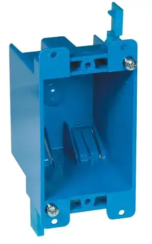

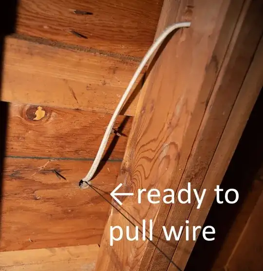

I would:
  • Put a 15A GFCI into the existing electric box
  • Install an old work box a few inches from the existing box
    • Just make sure it's in the same stud bay and you should be able to re-use the existing wire's chase-way
Heck, go ahead and put in a double-gang old-work box and run two 12/2 wires to it so you can have two dedicated 20A GFCI outlets.
