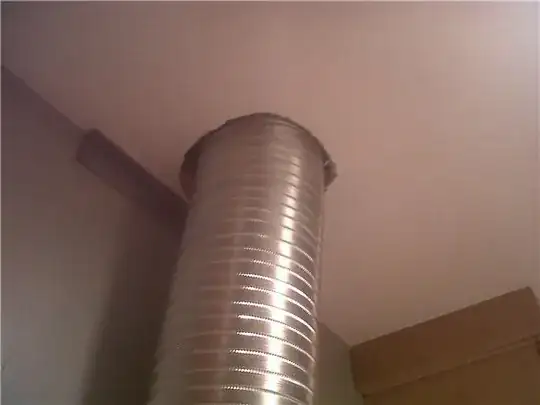

My new kitchen included a new exterior flute for a new range hood.
Few months later, I opened the cover for some maintanace reason and saw that the flexible flute is basically going through the ceiling via a hole cut into the ceiling.
The circular hole has about 1-2" space around the pipe... see picture.
How do I air-tight this? seems like all my house heating can just fly up into the attic this way...
alt text
I thought to use expanding foam, but not sure if that is the "right" way, also, if I do, can I use the cheap stuff or do I need the "fire" rated one? any ideas? pictures are most welcomed if you have something to show me...

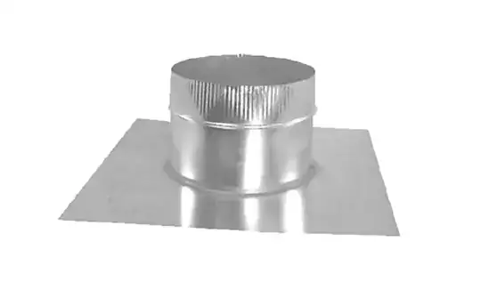

Otherwise, if you want it to look pretty, you could go find some flashing for a vent base that fits your duct. If the duct isn't easy to disconnect, you could cut something like this in half to fit around the duct where it is and caulk the seam afterwards.
