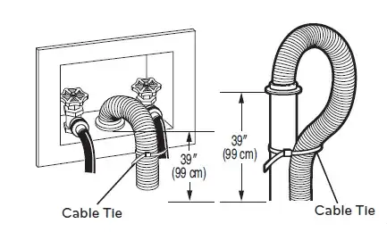

If you check the documentation that came with the washer, it should contain the maximum drain height. Generally, the maximum height is around 39" (99 cm).
Newer washers often have a drain hose permanently attached, which is designed to make drain installation fool proof. The supplied drain hose shows you exactly how high the washer can discharge.
