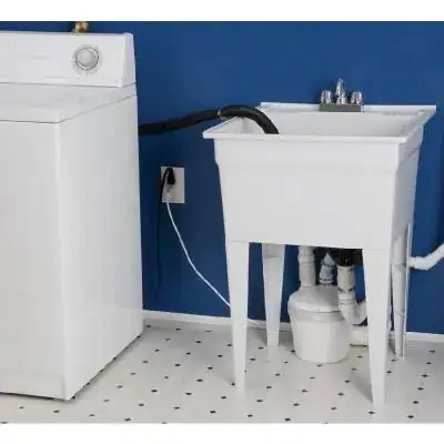

In homes where there are no drain lines in the basement floor, it's common practice to use some form of cistern containing a pump. A quick search at Home Depot turned up the SANISWIFT®, made by a company called Saniflo. The specifications list this unit as having a vertical discharge of 14 ft., which should be more than enough.
I've seen similar setups in many basements, where the only drain available is overhead.
Grey water from the sink and washer are collected in the cistern, then pumped up and out of the area when the cistern is filled to a certain level.
If the washer discharges faster than the grey water pump can handle, you're going to have problems. That's why when installing a system like this, the cistern should always be large enough to hold more than the volume of water that will be discharged by the washer. In the above image, the sink acts as a secondary reservoir (as well as an air gap) allowing the pump extra time to discharge the water. If you're not using a sink it's a good idea to have a larger cistern, and/or a grey water pump that can handle the volume.
You'll also want to install a check valve, on the discharge line from the grey water pipe. This will prevent the water in the vertical pipe from draining back into the cistern, and causing a potential infinite loop situation.

I would not even think about pushing the washer water to the attic. That is a disaster waiting to happen. Water goes down. You have two choices. Get the water over to the main stack - I am not sure of your setup but if you have a basement this is usually doable. The second option is to pump it out to the yard. Since this is not waste you can pump to the outside - you can ask local building inspector about local codes on this.

City folk can't drain grey to the street. The laundry tub would work great, treat it like a sump , which in the Midwest usually run consistantly and overhead. If good materials and workmanship are obtained you'll be good for years with the pump and indefinitely with the system. Use a lint sock on the washer discharge and read the pump directions, don't forget the airlock hole in discharge from the pump, between the pump and the bottom of the check vales, and no pumps that have free floating-floats (cable floats).
