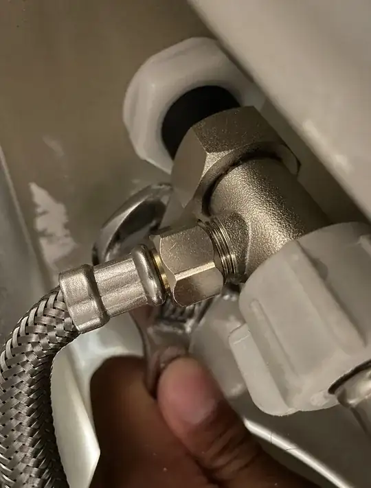

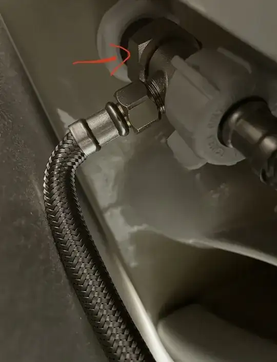

There is water dripping out of the part of the t-valve adapter connected to the toilet tank. The angle required to tighten the bolt with a tool makes it (seemingly) impossible.
Wrench? Not enough space to turn it. Pliers? Too big to reach it. It’s been tightened by hand as much as possible, but still leaks.
Even when I remove the other connections, the problem is still the lack of space to work with.
Any ideas for a solution? Thanks, kind folks.

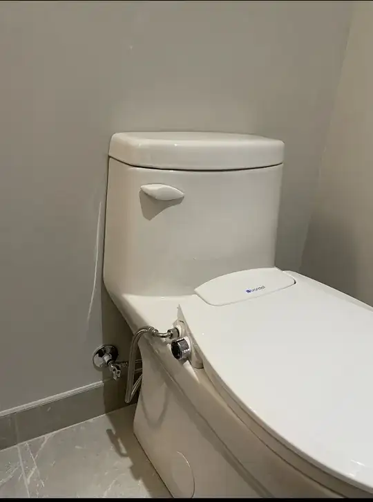

toilet at a glance rear of toilet near the wall showing the nut that needs tightening tool in hand for scale

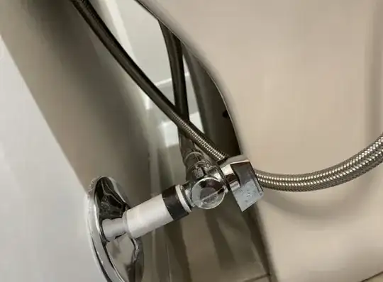

The installation instructions show a rubber washer in that T connection to the toilet inlet, so once you have it finger tight, it should only need another 1/4 turn or so with the wrench to make a seal.

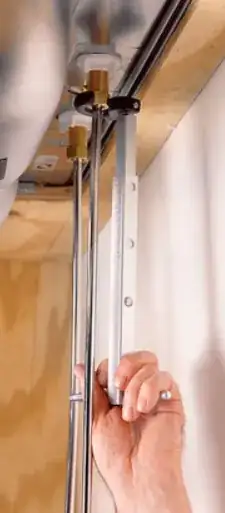

There are some specialized tools available for tightening nuts in tight spaces:
One is a "basin wrench" (example only):
