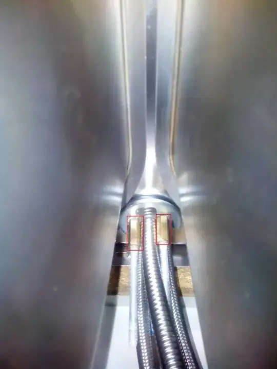

Recently I replaced a faucet in the kitchen, but there is not enough room to fasten two nuts. These are not the nuts on the end of the supply lines; they thread onto studs to hold the faucet down. They're too close to the supply lines to be able to grab.
I tried with a wrench and a rib joint pliers, unsuccessfully.
How can I fasten nuts without calling a plumber? Is there a specific tool to achieve this or something else?

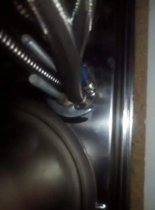

UPDATE: I added some pictures to explain my case better.
Pic #1: These are the nuts. At the moment, they have been tightened just by hand:
nuts1
Pic #2: As I said before, there is really not so much room to tighten due to sinks and pipes. As for pipes, they are almost attached to the nuts, hence a basin wrench is not the best option, in my opinion:
nuts2

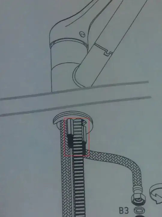

Pic #3: This is a detail from the faucet assembly instructions that shows a better perspective.
instr

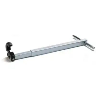

What you're after is a tool called a basin wrench:
Basin Wrench
It can reach up behind the sink and tighten those nuts.

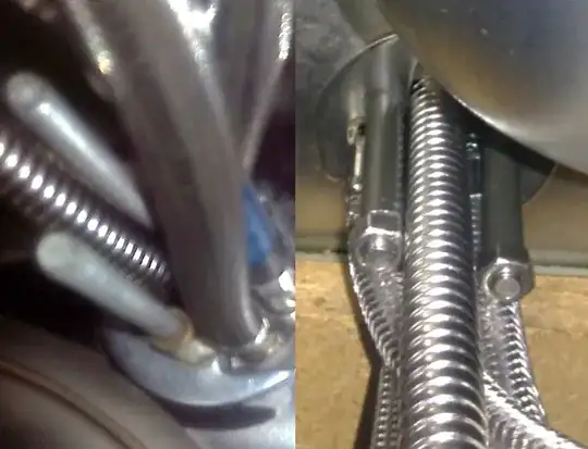

I had an idea that worked for me. I made spacers from steel brake line, and used a socket to tighten the nuts in a more convenient place for me.before and after

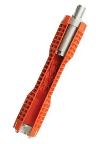

A basin wrench is NOT the correct tool to try to tighten the faucet mount nuts that you show in your pictures. Due to the nature of the valve construction another type of tool is called for to tighten these. The tool will look like a hex socket end but is able to slide up over the long mounting stud to engage the nut.
Tools of this nature are often made of plastic and included in the faucet kit. Included tools of course are manufacturer specific. Here is a picture of a generic version of this tool which can be purchased from Home Depot.

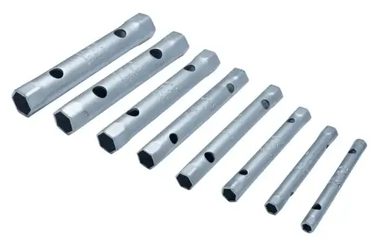

After some time looking for a proper solution, the only one I come up with is using a tubular wrench, and sawing the threaded supports that were too long. Maybe not the smartest workaround, but surely this faucet lacks a good design for assembling it.
These are some tubular wrenches similar to the one I used: enter image description here

To add to the tools that can be used in this situation is the crowfoot. Use it with an extension and a ratchet. (flank drive style pictured)

I suggest before installing the taps cut the studs down to a more usable length, then just use a normal socket on them.
