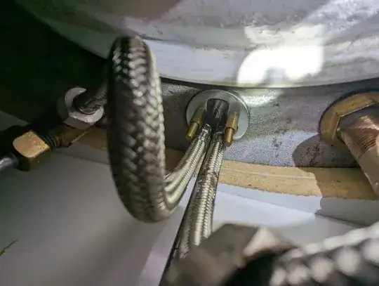

I'm attempting to change out a leaky water supply hose on my bathroom sink. Unfortunately, while I was able to disconnect the hose from the water shut off valve, none of my tools are small enough to disconnect the portion connected to the faucet. Looking online, the recommendation seems to be to use a basin wrench but I bought one and it doesn't fit in the tight space.
View from under sink
Anyone know how I can unscrew the hose from the top where it connects to the sink?

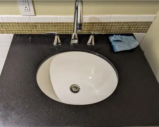

Edit 1: To clarify, sink is undermounted

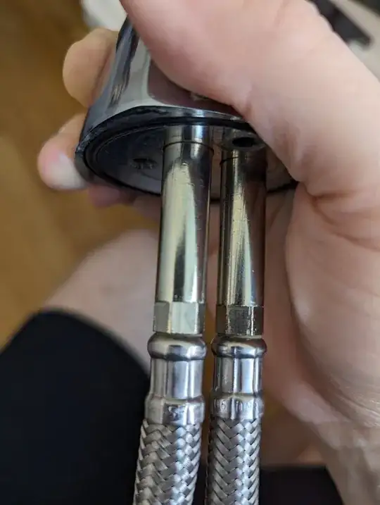

Edit 3: Faucet removed. Thanks for help so far. However, even with the faucet removed, I still cannot seem to remove the hose. Does anyone know from looking (picture below) if this is integral per the comments or do I just need to work it harder?
faucet removed
rl2230
rl2230
Those look like integral faucet supply hoses, i.e. they are part of the faucet assembly and can not be removed. Unfixable leakage due to supply hose defect requires faucet replacement.

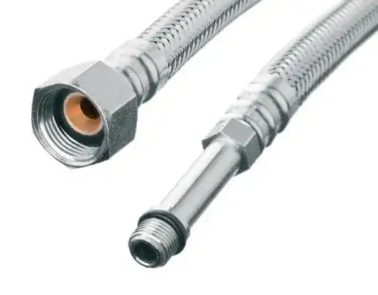

Typically these flexible hoses end with a specific fitting sealed with an o-ring. Diameter, length, and screw thread may depend on what faucet you have.
Usually you screw the hoses in the faucet first, then mount it on the countertop or sink. Doing it the other way around requires a lot more cupboard yoga. So you actually disassembled it the way it was supposed to be.
If you can't unscrew the hoses from the faucet, then maybe they were mounted at the factory and locked with thread sealant. Then you have to apply a lot more force on the hex nut that goes into the faucet. If you can't pull it out, you'll have to replace everything anyway, so you can go all out.

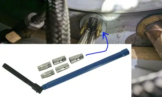

To mount it back, get one of these faucet wrenches:
