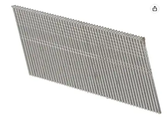

Anyway, back to the question. In a hurry, I used what nails I had on hand, 3" 16GA finish nails like the ones below; and now they need to be removed so I can reuse the boards (and repair the ceiling properly) but they are easily bent and therefore cannot be hammered out by tapping on their pointy end.
Is there a clever a DIY-hack to help accomplish that task?
16 GA finish nails

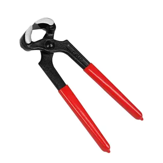

Use some nail pulling carpenter's pliers, also called Boot Pinch pliers in some trades.
These allow you to grab the shaft and pull the nail backwards. Or with some effort you can pull the head clear through the wood.
Another option is to grip the nail on the point side and push it back through the wood to make the nail head accessible.
This tool is cheap and versatile and should be in your toolkit for special occasions like this.
