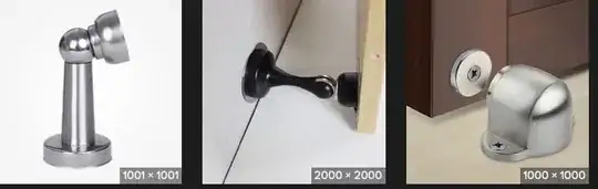

Some use magnet, convenient, no need to do anything to stop the door.
magnet

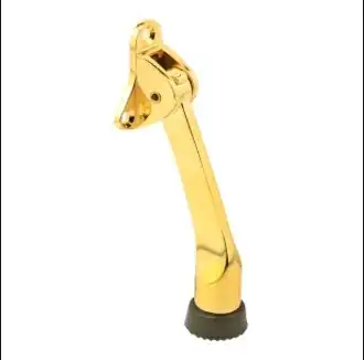

And very simple one. You do not have to do anything to stop the door. You will have to lift it (with your foot) to close the door.
stopper
Source: Walmart
