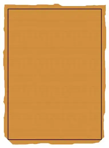

Suppose the black square is the area to be planed from the plywood, then cut near the 4 edges of near the square with 45 degree angle (2 bottom edges is done for reference in the attached figure) with a hacksaw blade or whatever and finish with a hand file (not really necessary). Later plane across the square as usual. The edges will look almost good, however while nearing the square, if you shift to a small smoothing plane instead of a jack plane, the result will be 100% perfect.
Sorry for my bad photoshop work.
