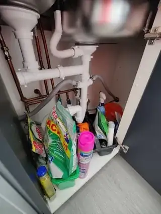

Come to my disaster of a cabinet under the kitchen sink... Now this isn't a slander of the workmen that did the job or the quality of their work. Everything works great, no leaks etc. But... the way in which they have installed pipes and cut holes for electrical cables doesn't leave much room for me to store my cleaning supplies.

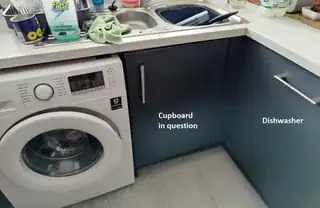

Now this is a double width cabinet with the main plumbing in the initial opening, taking up the majority of the space and an entirely empty full height space to the right. The unfortunate thing here is that the plumbing makes it difficult to actually access the big space next to it. Double-whammy.
So my question here is... Can anybody suggest how to improve this layout in such a way that I might be able to actually use the space?

All the supply and drain plumbing for your entire kitchen is in one easily accessible space where it can all be maintained without tools! This is actually pretty cool. Worth sacrificing an under-sink space. There should be a name for this and it should cost extra.
The only thing I don't like is the relatively small drain being shared by so many fixtures.
Gaining back cupboard space

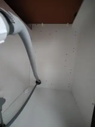

Corner Cabinet: For starters, you can gain back the whole corner area easily by clipping the dishwasher drain hose and power cord to the bottom of the countertop instead of running them along the floor. Just make a new hole in the far side wall near the top. Anyway the drain hose is supposed to make a high loop before its exit so just running it along the bottom of the counter will achieve both. You may need to buy longer hose and cable.
Main Cabinet: Waiting for more info on your venting and what's under the floor but pending that, my general direction is to split the five fixtures across TWO higher-level traps instead of the existing one, move the trap exits to the back of the cabinet, and transition from those intto a new larger 2-inch pipe that you route more conveniently.

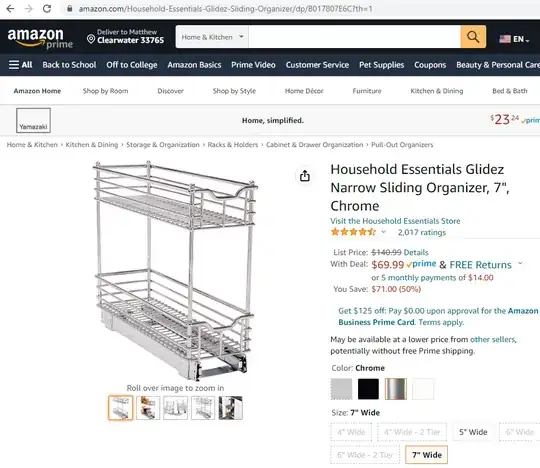

Building on Ecnerwal's answer. Put something like this in the dead space so it slides to the left. Put the stuff you access frequently in a basket in front of the pipes. Take the basket out and slide organizer to the left.

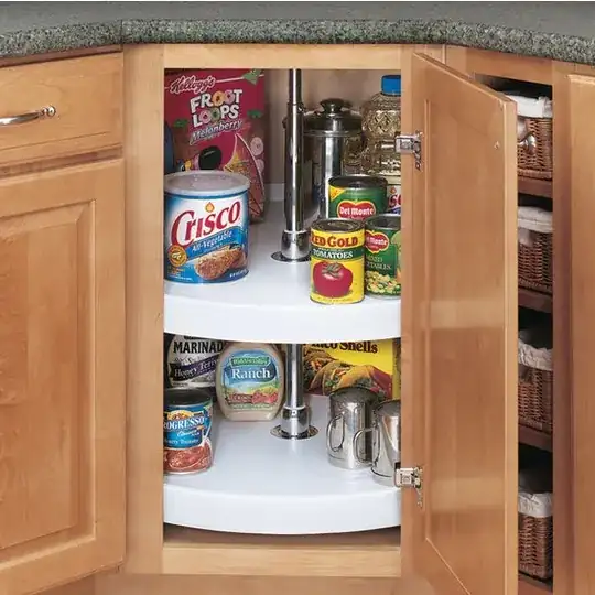

Whenever a kitchen countertop rounds a corner, you have a problem with what to put underneath the corner. In every kitchen I've ever lived in, they put a rotating shelf aka lazy susan there.
Also available with notches, to allow a squared-off door.
However they had a problem with that, because they chose to put the dishwasher around the corner, and you can't very well run dishwasher lines through a lazy susan (the pipes will knock over things on the shelf when you spin it).

In my aunt's kitchen, what they have is a double hinge corner door. A set of hinges holding two small(~a foot wide each) doors together and another set mounted on the frame to open both doors.
Your dishwasher seems to be about a foot away from the corner(guessing from the picture). So it might be possible to add a small door there.
If you replace the door under the sink with a half door, can probably add a corner door in the corner and have better access to far end.
