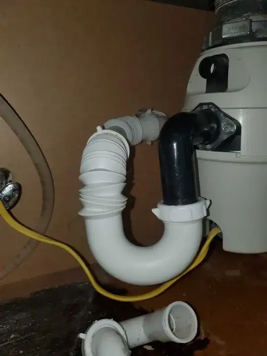

So we're remodeling our kitchen and my wife insisted we get a new farmhouse sink. We had a contractor install the new sink and after getting it put in he mentioned that the disposal line is about the same height as the drain line in the wall. Maybe the disposal line is higher than the wall line, but if it is its like millimeters higher.

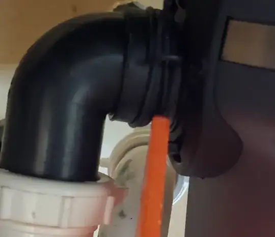

He connected it up using some of those flexible tubes and said we should be good. I was a little worried about this set up, so I tested it by pouring about 3 gallons of water from a bucket (we don't have a faucet yet) down the drain and then unscrewed the black tube line from the disposal. Water was sitting in the p-trap all the way up to the top of the this black tube, but was not in the disposer itself. I'm afraid that will be a problem once the disposer starts getting used again.

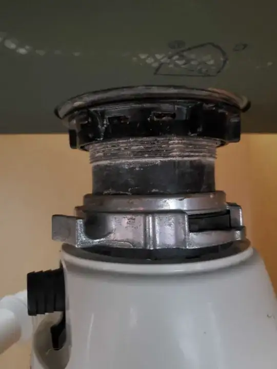

I was googling around and most suggestions are to either 1. Get a shallower sink (won't happen, wife won't allow it). 2. Remove the disposal (I use it every so often so I'd prefer not to do this if I can avoid it). 3. Move the drain line in the wall down (requires plumber because I ain't doing that haha). 4. IF THIS IS EVEN EXISTS, find a disposer with a shorter neck/flange. My current disposer is a Waste Master SS2600. Its probably 19-20 years old and original to the house, but still works fine.
Or is it actually ok the way it is set up like the contractor said? I've never actually explored a p-trap before, but I know they're supposed to hold some water. Is it ok if they're completely full up to the top of the black tube from the disposer?

I've attached some screenshots of the setup.
Water up to top of black pipe
DrainPic1
DisposerPic1

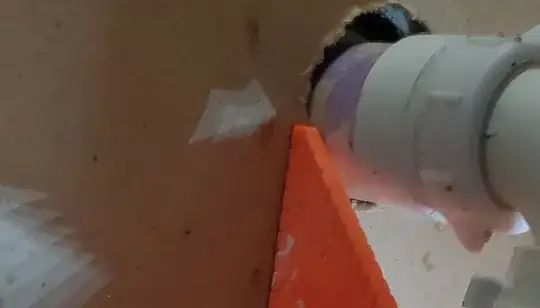

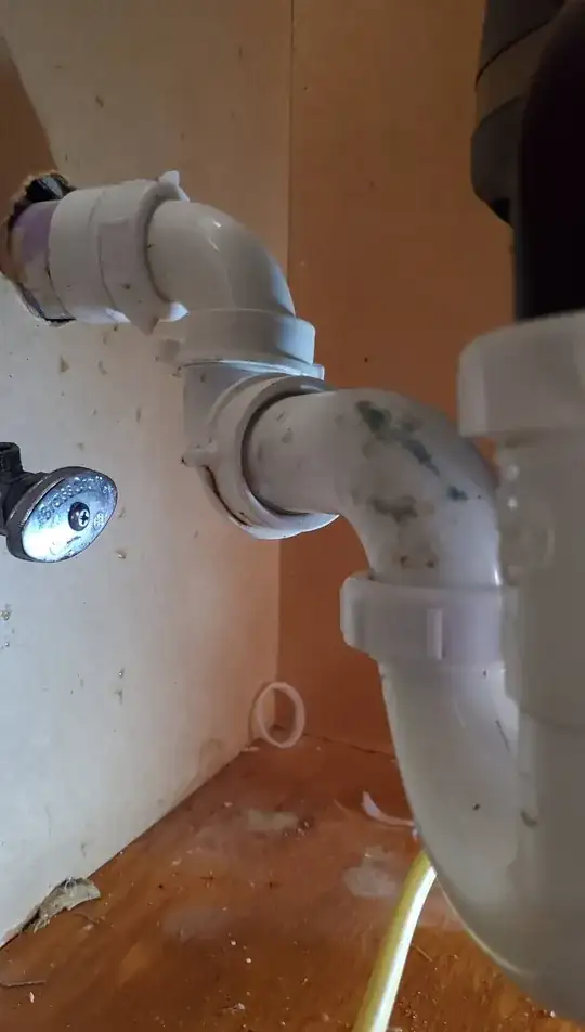

Update:
We'll the new disposal isn't much higher. MAYBE half an inch. Also the ptrap is now too close to the wall so I have to have it come off the side and have an extra elbow in there.
height of wall pipe
height of disposer pipe
new elbow pipe

Normally, there wouldn't be water all the way up to the 90° going into the disposal, however, that isn't inherently an issue. (You're not removing that pipe in daily operation, right?) So long as you don't have water standing in the disposal, you should be fine.
I'd agree with the comments that the much bigger issue is the accordion pipe. They're just not recommended.
When replacing that accordion pipe, simply raise the whole trap up 1/4-1/2" so that there is some slope from the top of the trap to the stub-out on the wall to ensure you've got good drainage.

It should be ok as long as your trap arm has the correct slope and is within the critical trap arm length to prevent siphon.
The accordion style p-traps as others have noted aren't recommended and would likely fail code.
Having the water that high does make servicing harder but it is difficult to lower the roughed in stub for the trap arm without removing cabinets and cutting drywall.
